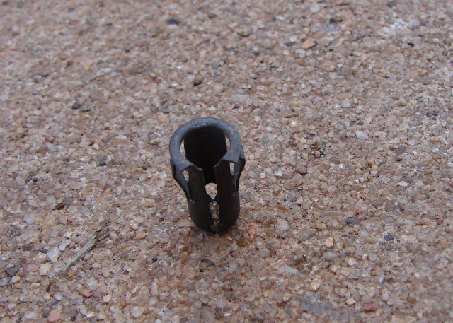

If you install trim inserts (see photos- not sure if that is the correct name) into the fender badge holes, you can simply push the emblem mounting studs into the inserts. You could also use double sided tape on the back of the emblem to ensure it doesn't come off.
I've done this with both of my trucks and it's worked great for over 10 years.

I found out what they are called, Barrel Nuts. Did you happen to know what size they are? I'm gonna go the route you had mentioned, barrel nuts and 2 sided tape. Just need to get the size right for ordering.

I recommend the barrel nut/double sided tape method, but if you weren't going that route you would just have to remove the outer fender.
The other method is much easier though.
