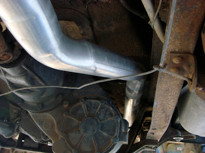

Does the back of your transfer case look like this? The tailshaft housing and the round cover at the back are aluminum, the rest is cast iron. The NP203 was originally a full-time 4 wheel drive transfer case that many people have converted to be a part-time transfer case.
If your t-case looks like the photo, then it is a NP203.
If it has been converted to part time operation, then it would have a Lo-Loc, Lo, Neutral, Hi, Hi-Loc arrangement.  In a part time conversion for the 203, Lo and Hi are 2wd Lo and 2wd Hi positions.  Lo-Loc is like 4 Low and Hi-Loc is like 4 High. You would engage the manual locking hubs for 4wd use. You should also drive it in Hi-Loc with the hubs engaged every so often to ensure that everything in the t-case gets lubricated.
How to tell if you have a part time NP203?  Ensure the front manual hubs are unlocked, put the transfer case into Hi and then put the transmission into drive. If you don't go anywhere, then it is still a full-time 4wd transfer case. If you move, then it has a part-time conversation.
An NP205 transfer case is all cast iron.  It has 4-Lo, Neutral, 2-Hi and 4-Hi positions (i.e., 4 positions versus 5 positions for the NP203).
The Neutral position could be used for towing the truck or if you are using the power takeoff (PTO) to run accessories, especially a PTO driven winch, where the truck would need to be stationary.
