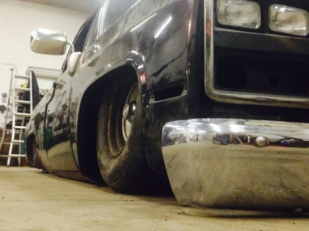

i like the stance.. how many inches of drop does it have?

Its a 5/7 drop done with belltech components, as far as i know/can tell. other than the flip kit bracket.

I put lower balljoint and outer tierod on it today. I noticed that the back end has 2" hanger drop, 2" shackle drop and a flip kit in the back. On the front its got 2.5" drop spindles and the springs are cut so short that when the truck is on the hoist I can move the springs with my hand. We'll see how this thing rides. It still has bump stops on the lowers i think they will have to be cut off. The 235 75 15's are hitting the inners so I may have to raise it all up. I feel like there is no way this thing has a 9" drop in the back but my other truck is in storage and i cant get a measurement to compare it too. i cant get the hoist arms under the front with out a floor jack. so it has less than 4" of clearance at the front cab mount
