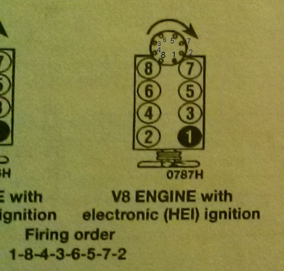

I incl. a pic of the firing order on the intake. I think the manual slated the order like a playoff bracket - 1/8(l/r front 2), 2/7, 3/6, 4/5.

IA - I'm gonna pull all the wires in the morning and recheck everything. i used ms paint to line up the firing order on the dist. cap. just lmk if everything looks good the way its laid out. ima get off at 830 so its gon be the 1st thing i do soon as i get a green light.

Re: So it isnt my fuel pump **TROUBLE CODES ADDED 4/19** *VIDEO ADDED 4/16*
« Reply #37 on: April 27, 2013, 09:42:11 am »
Yes the firing order is listed correct. Let us know how you make out.

Fixed plug arrangement, 2 were switched, checked after rearranging twice, everything good. Hit AZ this morning and picked up a new pcv valve and iac valve because i was gonna clean that one and reinstall it, well, it looked like garbage. So i bought a new one, put it in. Truck idle back to normal, straight idle when running, but same issue when driving. Hesitation, little acceleration. Not road ready by any stretch.
