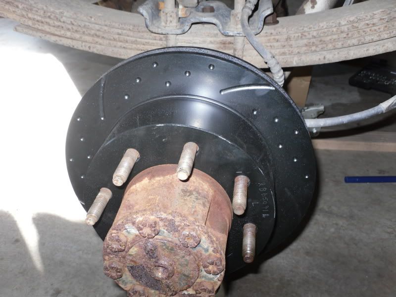

rotors im partial to brakeperformance.com as their warranty also covers warpage(sp). Plus you can get them in black zinc coated which ive always run and never had a single problem with them, never warped a rotor even hauling huge loads  and having to slam on the brakes because of other idiot drivers.   and they stand behind their products 100 percent had some come in with a small defect emailed them pictures and had two new rotors the next day.
one of the few pics i have of them installed.
They have some really good deals on rotors. I might order some of those up when I go to flush my brakes out. Get some of the slotted rotors and some good semi metallic pads.
