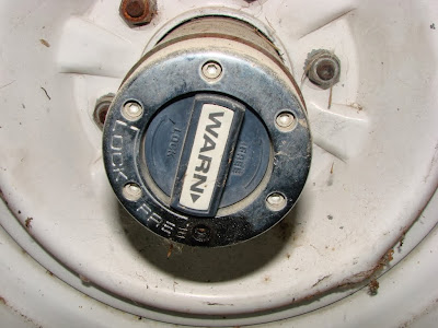

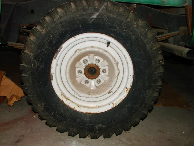

Here are some photos of my Dexter Wheel 16-inch 6-lug steel wheel setup with 7.50 x 16-inch bias ply mudgrips.
Front:
Rear:
Closeup of rear, 3.65" pilot (hub) diameter:
Closeup of front:
