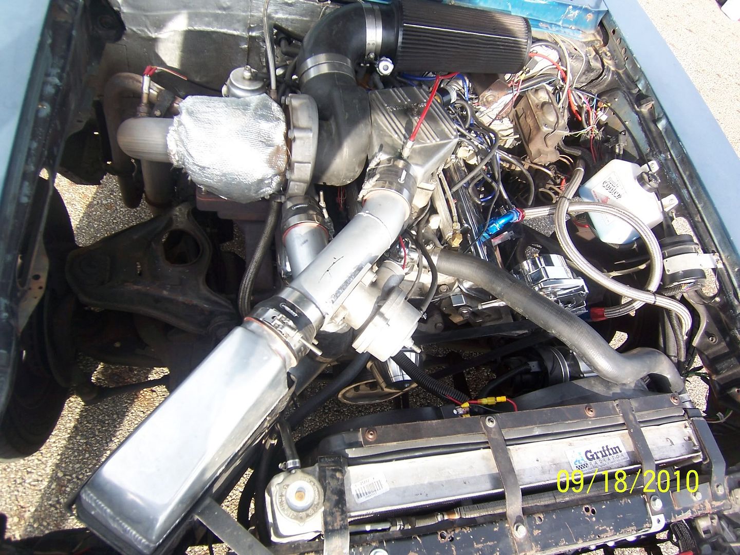

Has any one ever put a Martin turbo kit or anything similar to it on there small block? I found one on Craigslist and was curious to see if it was worth getting.

I have never used that brand of turbo before, but from what I know since its a "V" engine (V-8) you would want to run twin turbo's, because there is two separate exhaust manifolds, and turbo's force air out of the engine through the exhaust (were as a supercharger forces air in and only need one). You can run a single turbo with a "crossover tube" connecting the two manifolds together (which I cannot see in the picture) but it is not as good as an independent turbo for each manifold. I would run twin's if it was me, my $.02.

That is some real old technology there! How that works is this: The Left exhaust manifold (originally a stock rams horn) was connected to a crossover pipe in the original location of a SBC with a single exhaust (under the engine near the oil pan sump) & then up into the Right manifold which was a custom cast piece that had an INLET for the crossover & a OUTLET flange for the turbo to bolt onto...so both banks are helping spin the turbo.
The intake manifold is another story...It's a draw-through design in which the air/fuel mixture comes in the air filter, down through the carb & into the intake...then a 90* turn to the tube going into the turbo, then out through the other tube to the lower area/plenum of the intake & into the cylinder head.
The actual exhaust side of the thing can work rather effective & can make good power. The real question to that kit is what size is the turbo & what is it's condition? The whole intake deal really isn't the way to go...a blow-through of some sort (either carb or FI) would be a better plan.
Here's what I believe started out as a Rayjay kit very similar to what you have posted. However all he was using was the exhaust portion with an adapter to mount a bigger turbo sideways compared to the original design. I met Tom (the owner/builder) on DragWeek some years ago...it worked very well, however only the exhaust portion is left from the basic kit. Lorne
