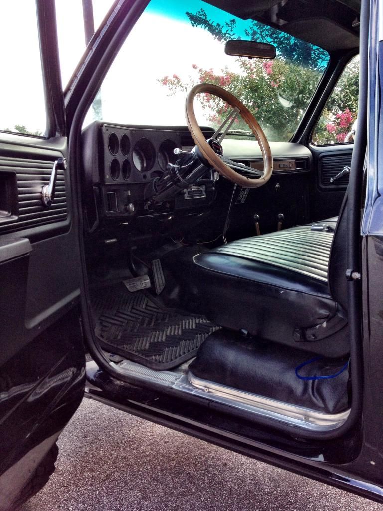

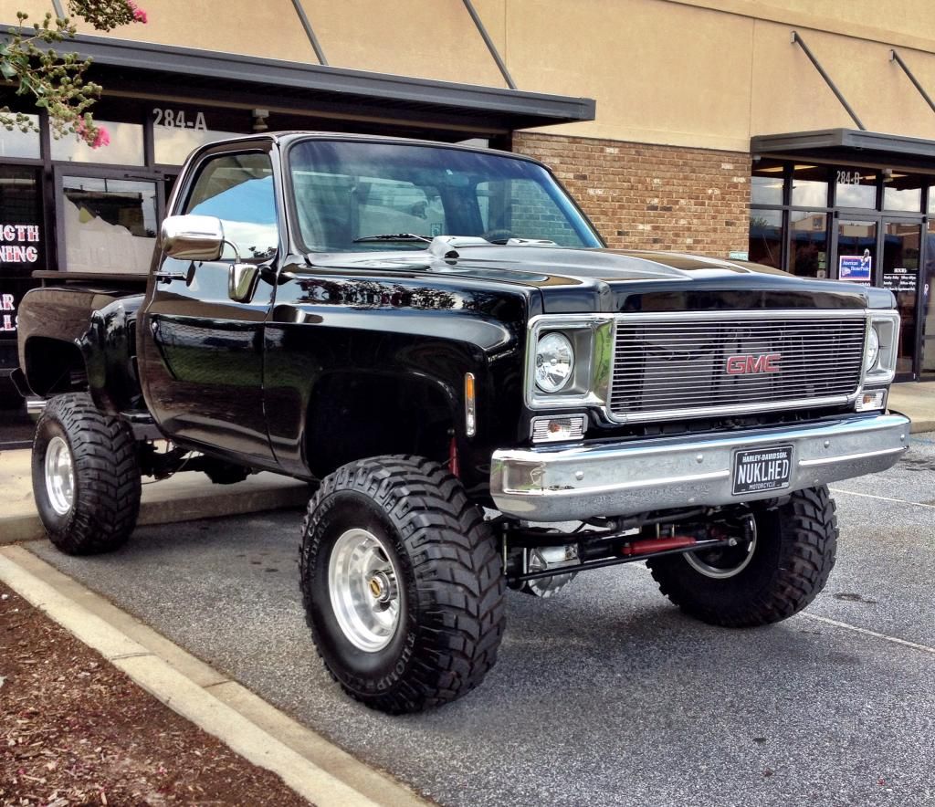

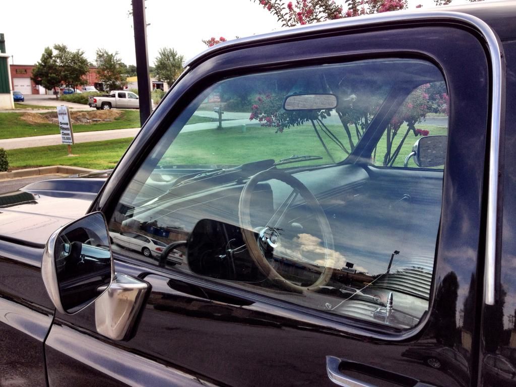

Completed this install today!! RAHHHH!!! The drivers side went a lot easier and I pretty much slapped it together 1,2,3. Total time today was around 5 hours plus 2-3 hours m,w,f.
 Where One Piece Products says to just shave that nut all the way off, what you really need to do is continue grinding and remove a bit more of the inner door hinge area to make that window go up and down easier. Kaos says all doors from 73-87 are the same but I can't imagine that to be the case. These '77 doors are a very tight fit with that one piece glass. We are talking millimeters! Only way to make em fit is to remove a little bit of material at a time from that inner hinge. Grind a little. Drink a little beer. Grind some more. Beer some more. Each time give it a test run. I had my rear door track as far back as it would go. After that the only give has to come from the front of the door area i.e. the hinge.
     I also blue taped the edges of my window frame to prevent scratches during the install of the door panel/inner window scraper. I highly recommend that also. Those rubber window scrapers have very sharp metal inside them at their end point like prison shanks. They will do damage quick so tape up those window frames and in my case I tripled that tape up to ensure it was thick and not going to scratch. The included 3M weatherstrip adhesive is good stuff. It sets up fast. I suggest you ignore Tapia's suggestion to use tape (doesn't work, the rubber scraper will just pop off) and instead use your man mitts and just hold on tight for 10 minutes while listening to conservative talk radio. The news about Obama will be enough to further your anger and ensure a nice strong grip.
This mod is not easy. This mod will make you want to murder people with a 1/2" breaker bar. The instructions are horrible. The instructional video is even worse. Do not murder anyone with the breaker bar. Keep your head about you and plan on doing this incrementally over 1-2 weeks. It cannot be done in speed except painfully slow.
But when it's done... dang does it look sweet!  It's one of those mods that only the serious chevy truck heads would ever notice. The result is a super clean looking cab and windows that bind worse than an old mans digestive tract.
But dang does it look good!

Pix are working now. Beauty. How about a side shot?
