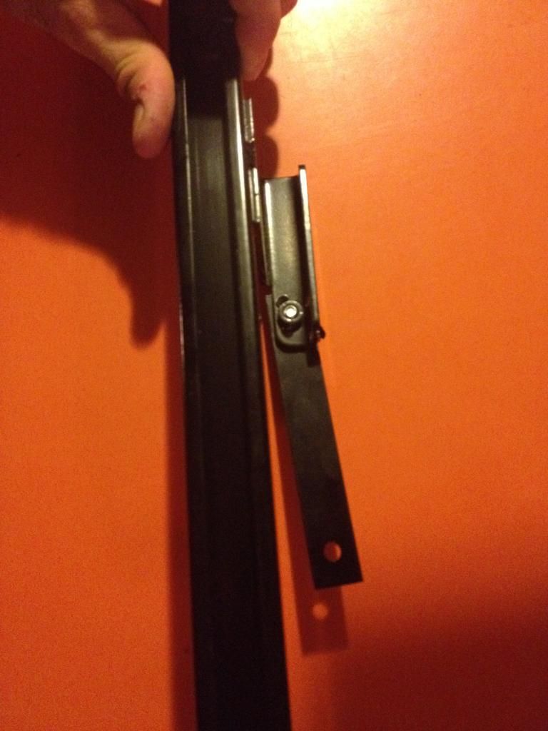

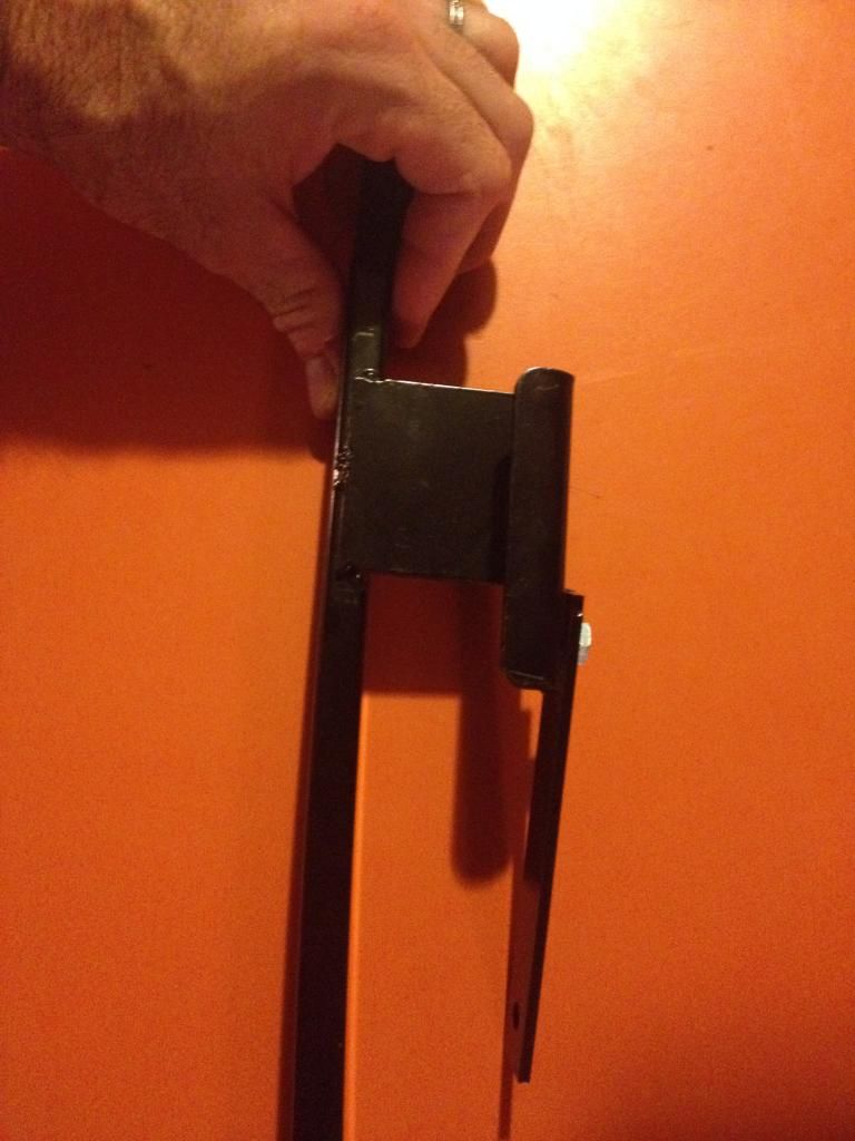

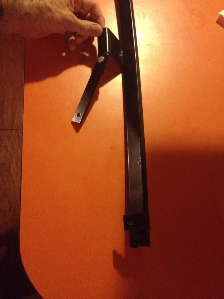

Mine will not mount to the back and mine are 90 degrees different where they bolt up and do not line up with any holes on the doors.
They don't bolt to the back of anything, they go where the vent window was attached on the guide attached to the front of the glass.  Where are you trying to put them?
The only thing that goes on the back of the door is what you removed which is the rear guide with the extension on it.  Pretty detailed pics are in the instructions.

Those vertical window guides are substantially different than the ones shown both in the directions and in the video. The ones in the video and the instructions have a different middle L bracket.
Mine are neither. Where I said they were 90 degrees different you can see in this photo where the bolt goes into the middle L shaped bracket. The one you show in your picture (which is not a blurry pixelated picture printed off of a household computer like his instructions are), if this IS the correct bracket it appears the bracket assembler mounted the mounting nut, on my bracket, in the wrong place. The bolt for the 4" bracket mounts towards the window track. It is impossible to mount the 4" extension how he shows in the video. He doesn't show in the video or the instructions EXACTLY how you mount this bracket up even if it was the correct bracket. Which, it isn't. It is not the same bracket in the video. Not even close. He failed on quality control.

You got all of this wrong.  It seems like you are trying to re-engineer the kit or understand how it works without reading the instructions. Read through the instructions again, lay out all the parts that came in the kit.
The bracket you are saying that you got incorrectly is the factory piece.  It is NOT supplied in the kit.  You are trying to put the extension that goes on the factory rear guide onto the newly supplied front guide.  It doesn't go there, why would you think it does?  If it needed an extension on the provided one it would have just been part of the bracket and not sent separately.
The guide you are trying to put that extension on bolts to the same holes as the Vent window channel does at the front of the door.
The extension goes on the existing rear guide at the back of the door that was removed with the original glass and uses the same holes as it originally connected to..
There is only 2 brackets that come in the kit.
1) Front vertical guide
2) Rear 4" extension, which bolts to the rear vertical guide that came in the door with the original glass.
I attached a picture of both front (supplied) and the rear (factory) guide with the 4" extension bolted to it for one side so you will know where they go.
