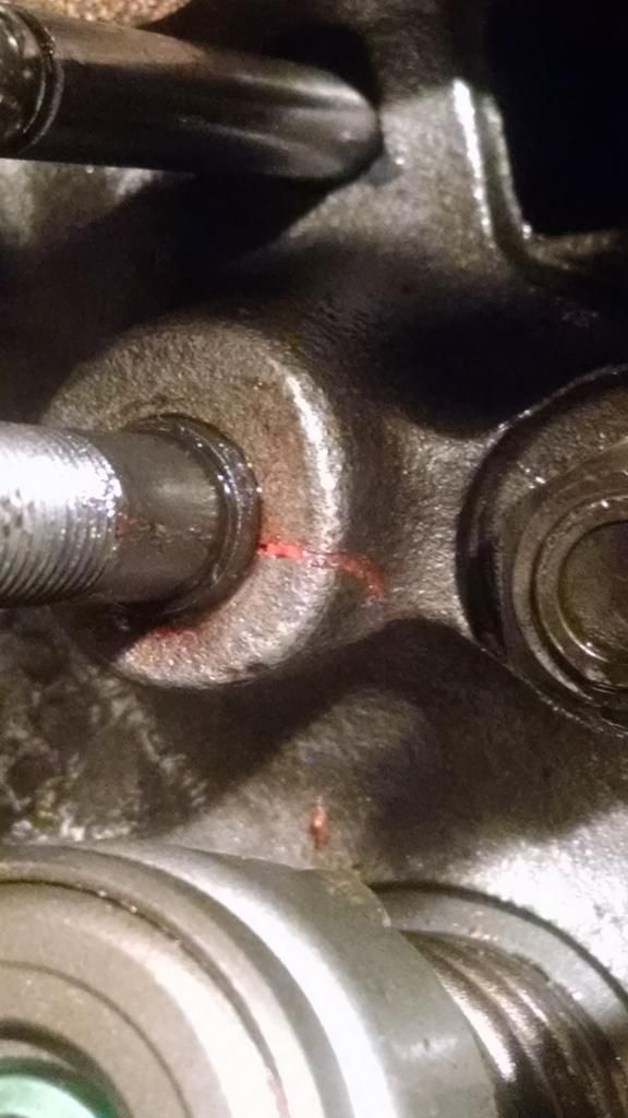

just noticed a crack where the studs screw in.... extremely mad and am wondering if I should even run this engine.
Whats the pro/cons of this type of crack and how can I fix it without swapping heads.

Cracks tend to migrate.  The builder should have Magnafluxed the heads before installing them.  I wonder if that's why the heads have the cheap screw-in studs?  Don't do anything to repair or alter it until you speak with the engine builder.  Can you find a way to post a pic?

i will get a pic soon.
Is there any way that the studs could have damaged the head? Maybe from installing too far? Im trying to spitball some counter points they may make.

     Pic??
Does the crack intersect the stud hole?  If the stud was threaded into the hole deep enough to force the collar below the top of the hole, the collar could have wedged the hole outward at the opening, resulting in a crack.  If the hole wasn't threaded sufficiently deep using a bottoming tap, the hole could have been wedged outward from the base of the hole, resulting in a crack.
Stud bosses are narrow; there isn't a lot of reinforcement.  The narrow flange of the collar should be sufficiently wide to seat against the top of the stud boss, but just barely.  That's why you need to be observant and careful when tightening the studs into the head, and not overdo it.
Did you discover the crack during disassembly - was it delivered that way?

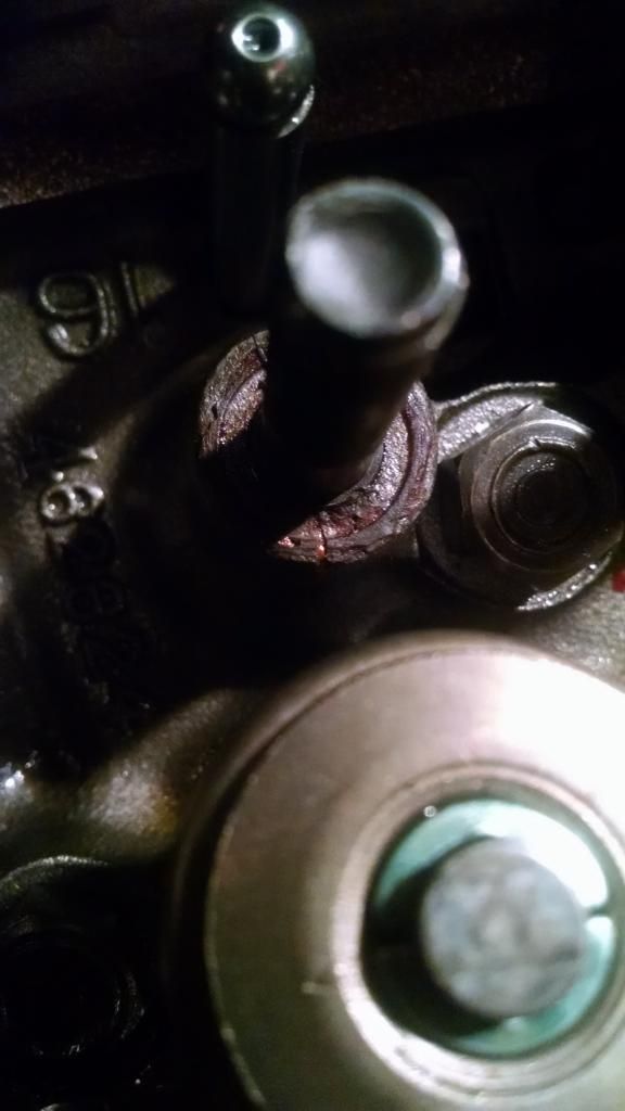

I put RTV in there to show the depth of it.
Another cylinder i think #3
Exhaust of #6
Sorry for the delay.
I noticed when I was putting the studs back in. There is no way I over tightened them. I followed your directions to the T. I just think they missed this when they built it.
Im calling them tomorrow to figure out what they are going to do about this.

In the 2nd and 3rd pics, the collars of the studs sit too deep in the bosses.  The narrow flanges of the collars should sit nearly on top of the stud bosses, not well below the surface the way they are.  Because stud holes often penetrate the water jackets of heads, the collars are intended to augment sealing against potential coolant leaks by jamming tight against the tops of the bosses.  If the bosses were already cracked from the builder, it's a shame you didn't see it during disassembly.
