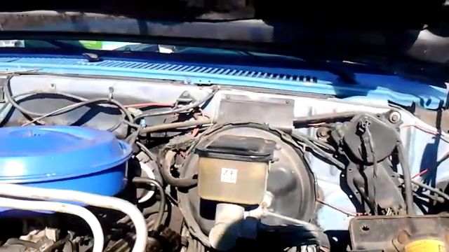

. Heres a video of blue running. No codes or my light doesn't work. And help?
I did unplug the smog pump electrically and plugged the vaccum line. Other than the other things I previously mentioned I have unplugged the IAC and no change at all. I unplugged the coolant temp sensor and idle went up slightly but all symptoms were still there.

It sounds like an exhaust leak

« Reply #13 on: December 27, 2014, 12:50:36 pm »
you probably blew out a spark plug insulator

Cap.. After posting it I'm positive its an exhaust leak
Vile..I'm gonna check them in just a few. If I don't get him running in 3 days I smell intake and carb!!
