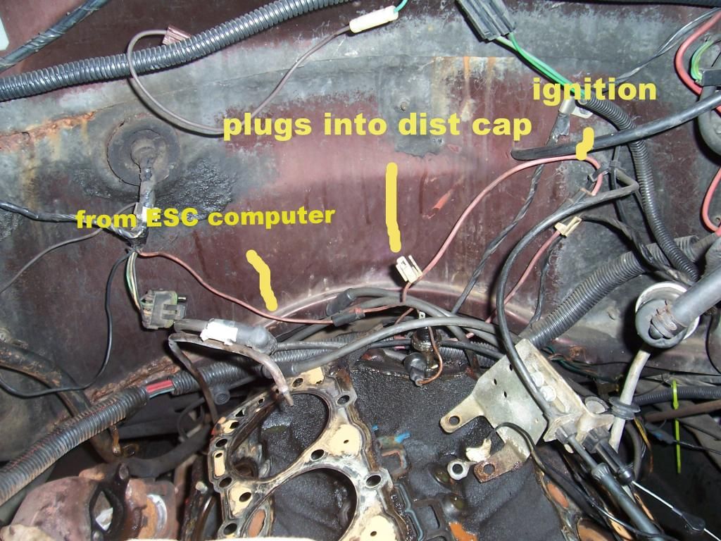

If we could re-visit this topic, i need a little help understanding the sticky:
http://www.73-87.com/7387garage/drivetrain/escrepl.htm
In order to bypass the ESC function, it says to unhook the spark control computer lead from the pink wire and hook the pink wire directly to the dist. cap.
Let's look at my setup:
As you can see, the pink wire from the computer already goes into the distributor cap.   Unless he means unhooked further down the line?   And furthermore, if i'm not going to be using the computer, why do i need this wire at all?  Maybe i'm not understanding it clearly.
i do understand having to connect the green and black wires, but do i need to reconnect this plug to that ESC harness to create a ground or something?
What i'm trying to do is----the 4.3's distributor is ESC and i want to bypass the ESC function.  As you know the 305's distributor from the 78 malibu which is non ESC has a different star-wheel and another part which i forgot the name of, otherwise i would just use that distributor.

« Reply #20 on: December 17, 2014, 10:02:39 pm »
If you are swapping in a non ESC distributor, you just need the power wire Labled plugs into Dist cap and plut it in.
All the other wires from the ESC are useless...

Did the ESC bypass by connecting the green and black wires from the secondary harness.  i still don't understand the whole pink lead from the computer but i'll figure it out.
