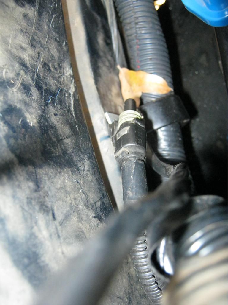

Also, there is a spare connector sticking out of the harness that I don't remember. It doesn't go to anything I know of and wasn't marked. I don't know where it came from.

As I understand it, "acc" is when you turn the key backward one notch. There is no CEL in that case. Only the radio comes on. When I turn the key forward to "run" when all the gauges turn on, the CEL blinks one time, then holds steady until I start.
Quote
Here's the connector, down behind the distributor.
And a slightly better pic.

Thanks VZ for the diagrams. Those are very helpful. I don't find that connector on them and there isn't anything nearby that it will reach so I'm not going to worry about it.

a/c sensor?
