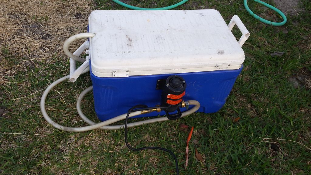

So I went all out and got me a parts washer...well I made one from things I had lying around the garage.
Offline LTZ C20
  • Posts: 3795
Re: Getting a little fancy... 1987 V10
« Reply #145 on: March 21, 2016, 09:48:28 pm »
Redneckery at its finest!

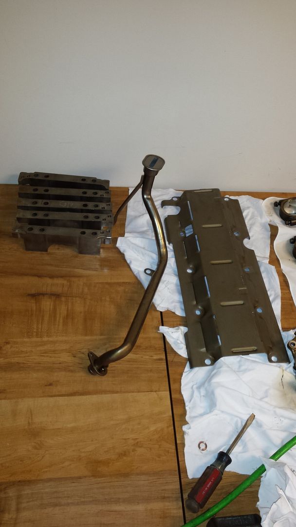

Proof is in the shinny stuff... all I did was pull these out and wipe them down..

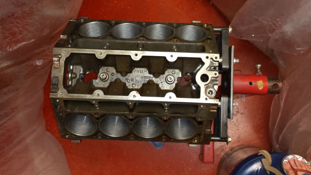

Bores are. Leaned up next will be cleaning the block and swapping pistons then reassembly. Hopefully in the next couple of weeks I can have the rotating assembly torqued in its final resting place at a very minimum. The hone I used was a little expensive but as we all know good tools produce good results and great tools great results.
