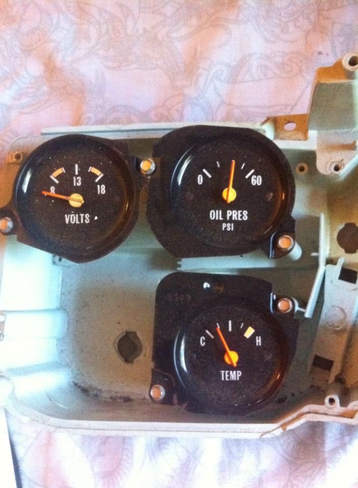

Hey, sorry to hijack the thread but it is related. I'm working with the factory oil pressure gauge and it has 3 posts. I'm trying to figure out which one is ground, positive, and for the sender. I do not have the truck, just the gauge. I want to test it, it is out of the cluster. Attached are pics of the gauge in question. If anyone can tell me which posts are what that'd be very helpful
Offline 78BIG-TEN
  • Posts: 261
Re: Oil pressure guage
« Reply #4 on: April 27, 2015, 09:01:53 am »
pin on the bottom should be ground.For the sender it will be the 1 not common to the
other gauges as looking from the back at the printed circuit
