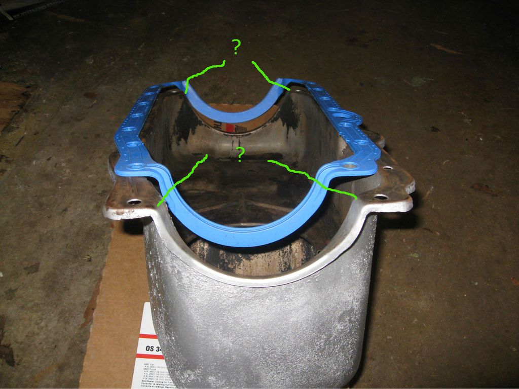

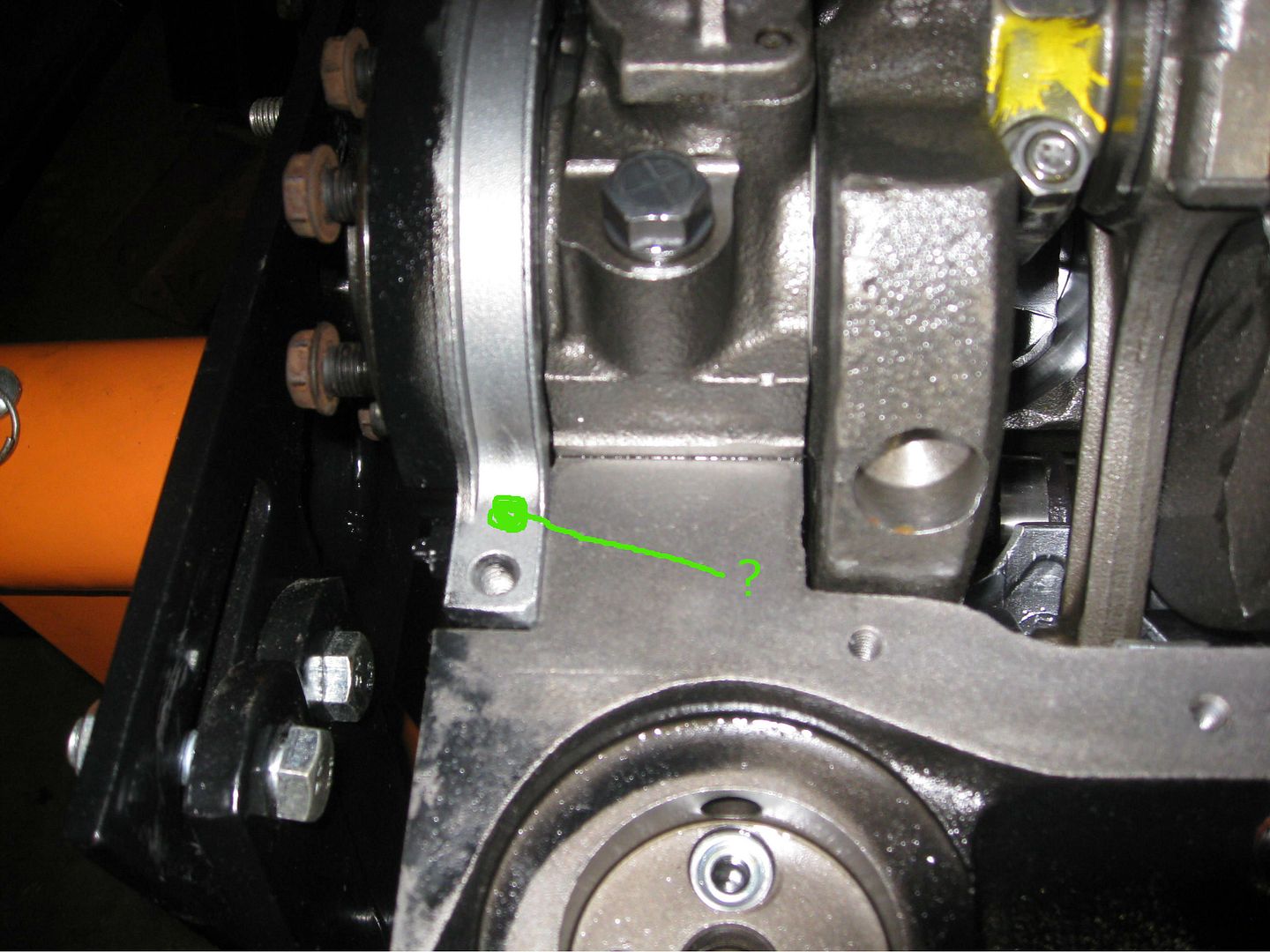

So, felpro is saying to put "a small amount of RTV to each of the 4 corners on the block side of the gasket."
The service manual says to put  " A small amount of  RTV sealant (GM  part number 1052751  or  equivalent)  to  the  front  and  rear
corners of the oil  pan."
After putting the 1 piece gasket on both the block and pan, it appears that the only place it could leak would be the rear at these two points:
But basically what is meant by the "corners of the pan?"
For the front seal, the gasket is actually pretty good and it appears that the only place it might leak would be here:
And for the rear, this looks like a possible leak point:
i've also seen someone on the 'Tube using no sealant whatsover and getting no leaks.  Will try to post the link.
« Last Edit: June 08, 2016, 06:35:20 pm by Stewart G Griffin »
Re: Oil pan gasket
« Reply #24 on: June 09, 2016, 03:07:30 pm »
if im using rtv on a gasket its only to hold it in place while its being assembled. I would apply it to each corner of the pan and let it get tacky then place the gasket on with the bolt holes lined up and let it sit for a few minutes. This is how I would do it vile might do it one way the book may say one way and the direction may say another. If in doubt I would follow the direction from the gasket cause it would be the most up to date instructions with research behind it

 If your using the  one piece felpro, It comes with the plastic stud retainers that screw in the block to hold the gasket up while you install the pan.
Very nice.
Just a very light transparent smear of RTV on the surface when installing gaskets when needed, otherwise none at all.
