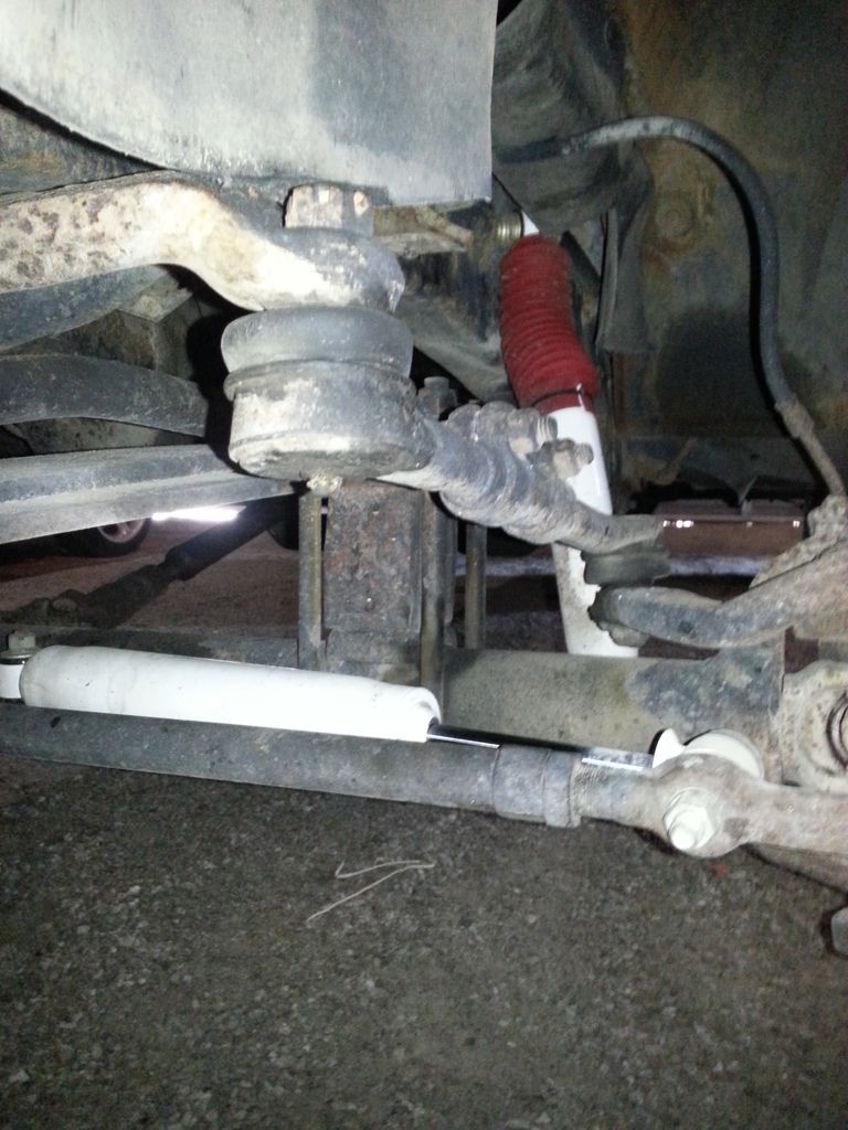

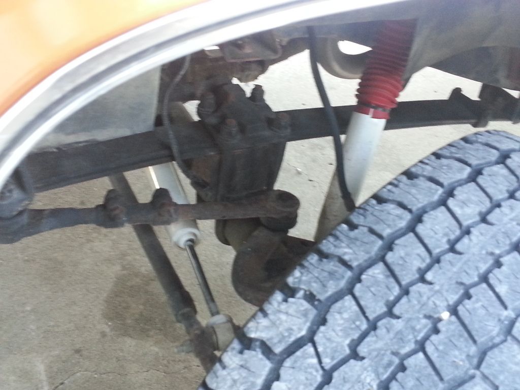

New member here. I bought my K10 last Friday knowing that the steering needed work. It has a 4" lift. The truck pulls to the right and when I hit bumps in the road the truck sways/pulls to the right. I was wondering if someone could tell me what to look for or buy to fix this. Thanks!

Dear effing lord take that truck off the road IMMEDIATELY! That thing is an absolute death trap.
1) You have blocks in the front; BAD
2) Your pitman arm looks janky
3) Your steering arm is wrong
If I can find 3 things that are bad just from your pictures I would hate to think what else is wrong with that truck.

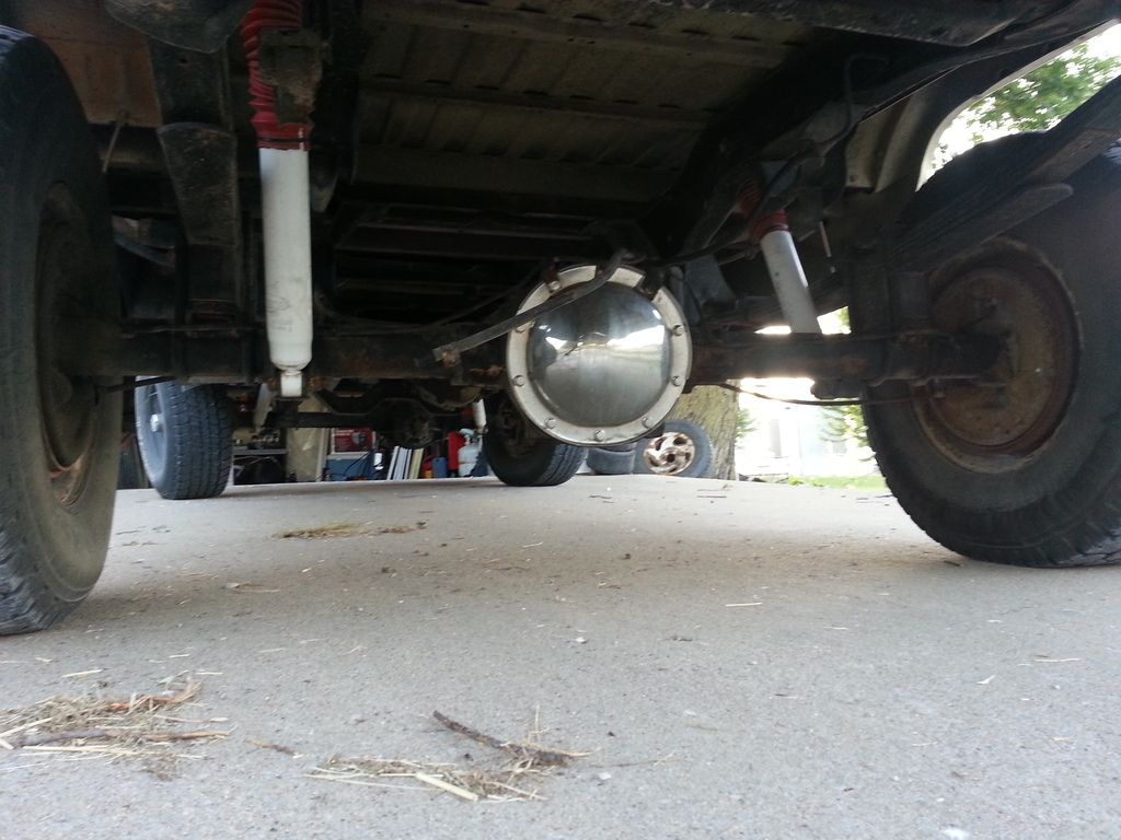

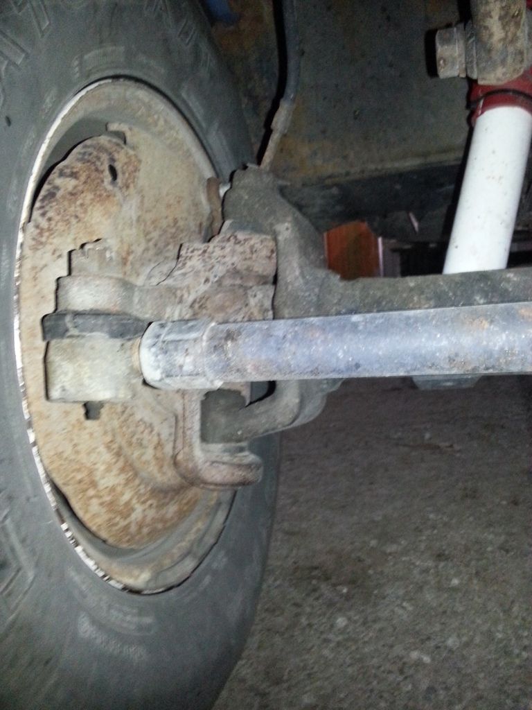

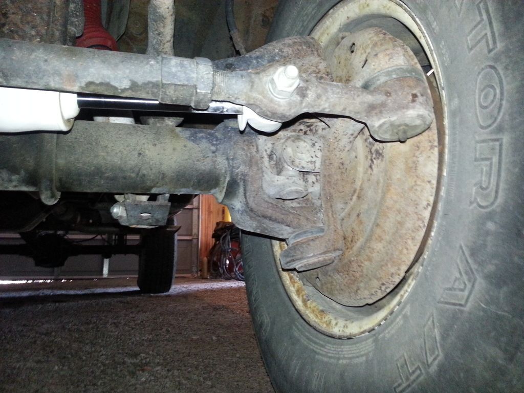

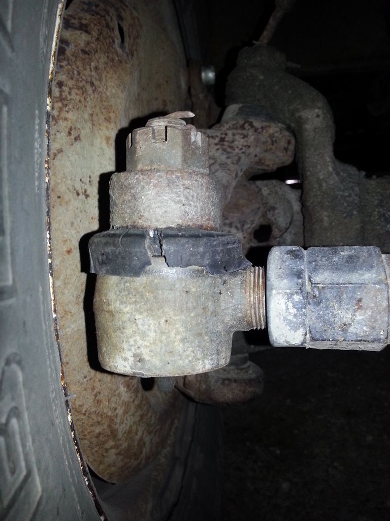

« Reply #3 on: September 08, 2015, 07:02:49 pm »
Here are some more pictures. I'll probably take the block in the back out as well. How to I lift the truck safely?

Need to buy lift springs. Also check the rear, if that has 4 inch blocks too-just drop it to stock height, or get the whole lift kit(minus shocks). I think some kits sell the drop Pittman arm with it.
As for steering arm, if any welding or bending has been done to it, you'll need a new one
You can check state laws, but some don't allow blocks or over 2 inch blocks

Here is what is wrong:
Blocks on the front. Replace with lift springs.
Steering arm needs replaced with a 4 inch lifted steering arm
Right tie rod is shot which caused the truck to pull. Personally I would replace both. Measure the length of each one before removing.
The rear vent needs fastened to the bottom of the bed. You might need to lengthen both front and rear vent hoses.
Take a close look at your front brake lines. Make sure they are not too tight when you turn the wheels to full lock.
I would also repack the front wheel bearings also soon as I could.
Check the front brakes while you are into the bearings.
