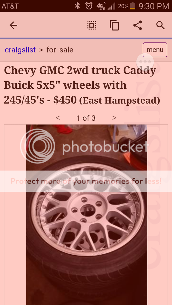

So long story short, I spent good money on some nice wheels that came off a caprice and they don't fit my 77 big 10. Hubs are larger on the big 10 apparently.
What can I do to make these work? Or atleast opinions.
1. Have wheel hubs machined to fit
2. Spacers may do the trick, but hard to find hub centric that changes size.
3. Resell (don't want to if I can help it)

What year Caprice did the rims come from?  Unless they are aftermarket all big bolt GM rims should fit our 5 on 5 C10.  Any pictures?

« Reply #5 on: September 20, 2015, 07:34:59 am »
That's a screen shot of the original craigs ad. The pic I saw of the wheels on a car was just the front clip, it was a round car and not the square of the early 80.

« Reply #6 on: September 20, 2015, 08:04:52 am »
Those rims are for a FWD car with that offset

« Reply #7 on: September 21, 2015, 11:51:45 am »
I'm curious what they fit. 5x5 bolt pattern with 1" back spacing. Not even enough back spacing for my saturn vue

« Reply #8 on: September 26, 2015, 08:39:21 am »
They look aftermarket anyways.
