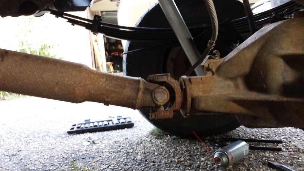

Wait a second.... you said this is a 6" lift? Which lift kit? Because we need to know if it gave you 4" or 6" springs.
From your pics it looks like a 2" block then the shim.

Okay blocks must be barely tapered. Spun the blocks around and its a little bit better. I'm going to spin the wedge around and but the blocks back how they were and see how that sits.

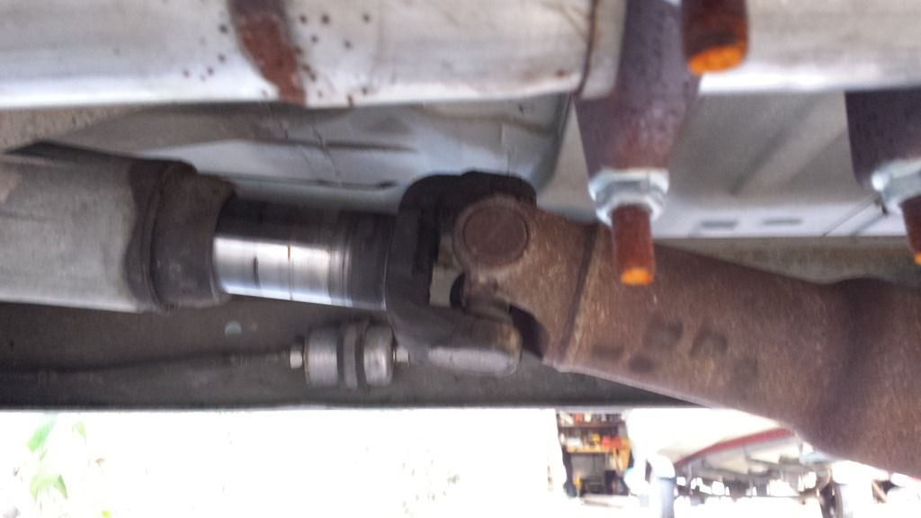

Put the block so that the fat part was on the back and put the wedge fat side forward. I think the angle is to much and the driveshaft looks like its trying to fall out. Idk what to do :'(
Maybe just remove the wedge? That's not easy because I have to unbolt the shocks and brake hose to get the rear end low enough. Why isn't rough country helping??

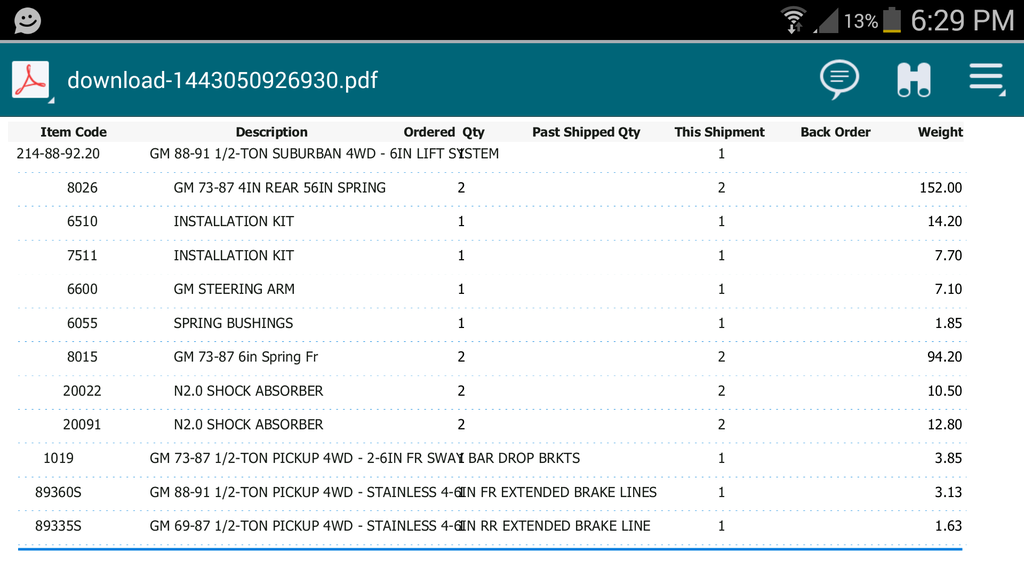

It is the 6" lift but they give you I think the 4inch springs and the 2inch block makes 6. Also I'm a newbie at lifting trucks and have no idea how to get an accurate measurement. I would suspect the wedge needs removed because it is used when you are doing the 4" lift and the block is all the angle you need with the 6". The block is  a lot less tapered then the wedge. Sorry for being an idiot here...

Its perfectly fine but you need to take a step back and breathe for a moment. Start with the simple things.
Remove the shims and ONLY use the blocks nothing else and make sure the angle on the blocks points towards the FRONT of the truck.
Do you have a part number for this kit?
Offline Motorhead337
  • Posts: 55
Re: Pinion Angle Help
« Reply #22 on: September 23, 2015, 06:31:17 pm »
Here's the kit
 http://www.roughcountry.com/gm-suspension-lift-kit-214-88-92-20.html
And here's a break down of the parts

Well everything should work. I say pull the shims and just use the blocks.

What is the pinion angle with just the 4" springs?
Can you take a picture of everything far away so we can see the springs and axle together.

i know i had to rotate my springs to make the drive shaft fit in my 79 with a 6" rough county lift

Shorter side fwd from my experience.   Also with a 6 inch lift driveshaft length could be an issue.
My k 5 has 4inch tuff country springs and  a 1 inch zero rate block no taper with no shims required for equal angles.
