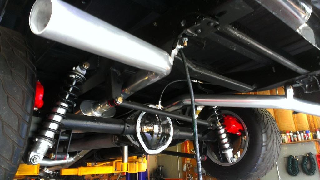

« Reply #14 on: December 22, 2015, 09:31:35 am »
This truck has a big block with 3" exhaust and it is loud but not inside the cab
