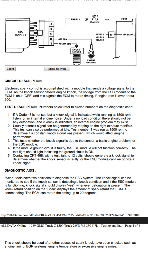

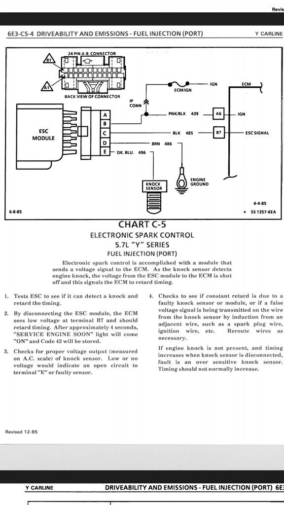

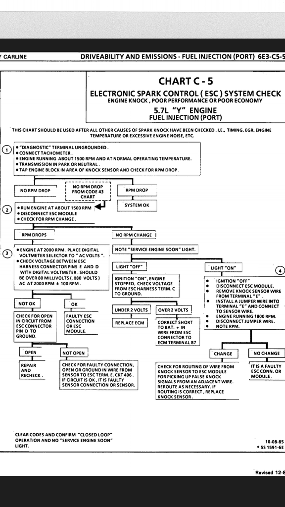

My first shot would be the ESC. And there is a procedure for testing it which I will post however I would first start by simply unplugging the knock sensor wire, tie out of the way and take a spirited drive. Then try one of these. ..

« Reply #4 on: January 27, 2016, 07:40:04 pm »
