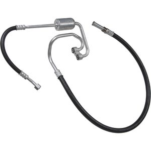

Offline OldGray
  • Posts: 169
  • Ne'er-do-well
Re: HELP ASAP! Need a Part Number
« Reply #3 on: May 14, 2016, 10:44:34 pm »
DustyRusty - the one you pointed out (pictured below) goes from Compressor to Condenser and from Compressor to Evaporator.  And I already bought that one.  The one that is a single hose that goes from Condenser to Evaporator is the one I need and it is like it does not exist on the internet.  Not one single Auto parts store I called even shows it in their system.
Frotosride - Thanks - let me know if you find it.  3 hours at the computer and no luck for me yet.
