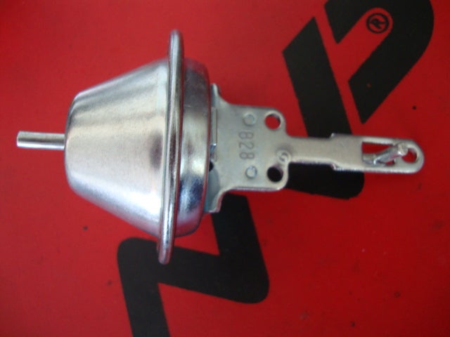

What vacuum advance can is on it?  (Numbers are stamped on the metal tang visible between the vac can and the distributor cap.)

Well, if pix 2 and 3 were taken at the same crank position, then #1 is forward, which is right.  And the vac can comes off at the right angle, so that's right.
The vac can normally has a number on it, like this:
http://www.nastyz28.com/~copo/images/b28_va_can1.JPG
So that's not a stock vacuum advance canister.
But, you said the timing indications are off even though the vacuum was disconnected, so that's not it.
