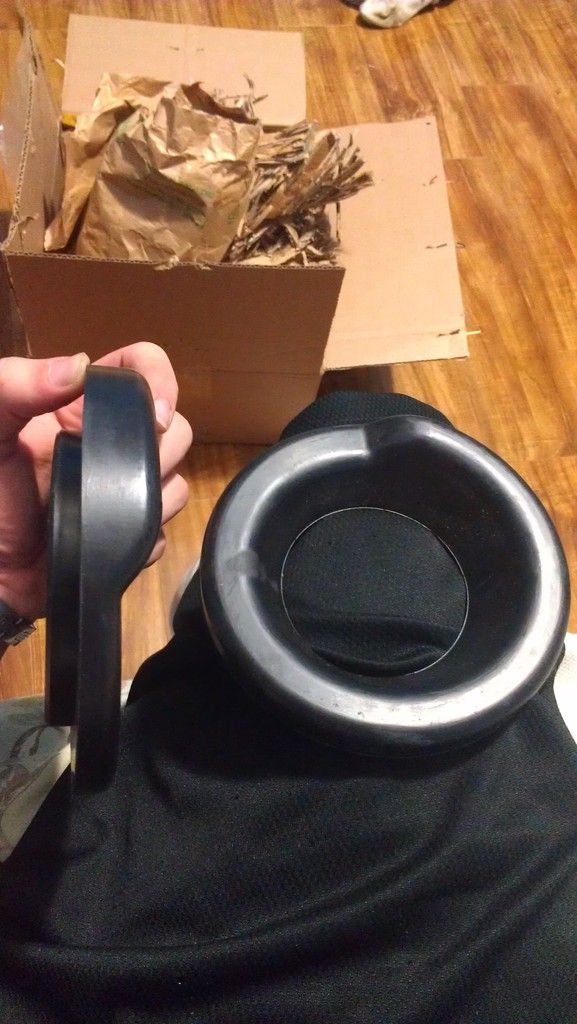

I just got some 2 inch lowering coil springs and the insulators that they came with are pretty thick. They're so thick that I'm thinking they might actually take away some of my drop.
I remember when I changed the springs on my previous truck (1990 Short bed) the insulators were only about a quarter inch thick. These are about an inch thick.
Have you guys ever used these kind of insulators?
I'd really appreciate your opinions thanks.

if you got a 2" lowering kit and the spacers only make it a 1" kit then the company would probably be sued for false advertisement. i would think the spacers are adding into the 2" drop
Yeah your probably right. I'm gonna go ahead and throw them in. Thanks

If you had'nt figured it out yet,the 1 inch thick spacers are included if you only want to drop 1inch in front,if 2 inch leave out spacer and just run the stock thin insulator.
