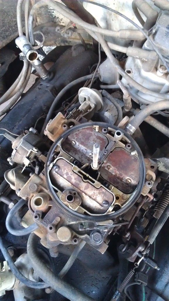

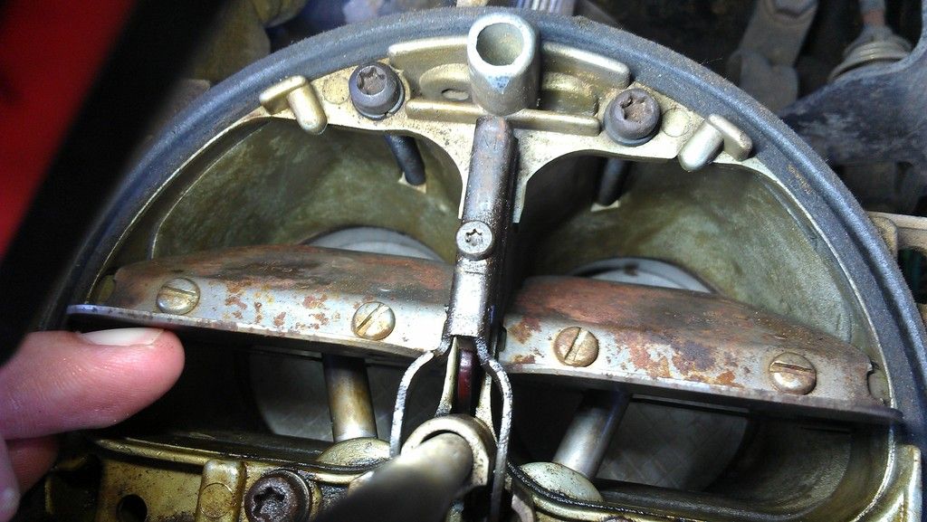

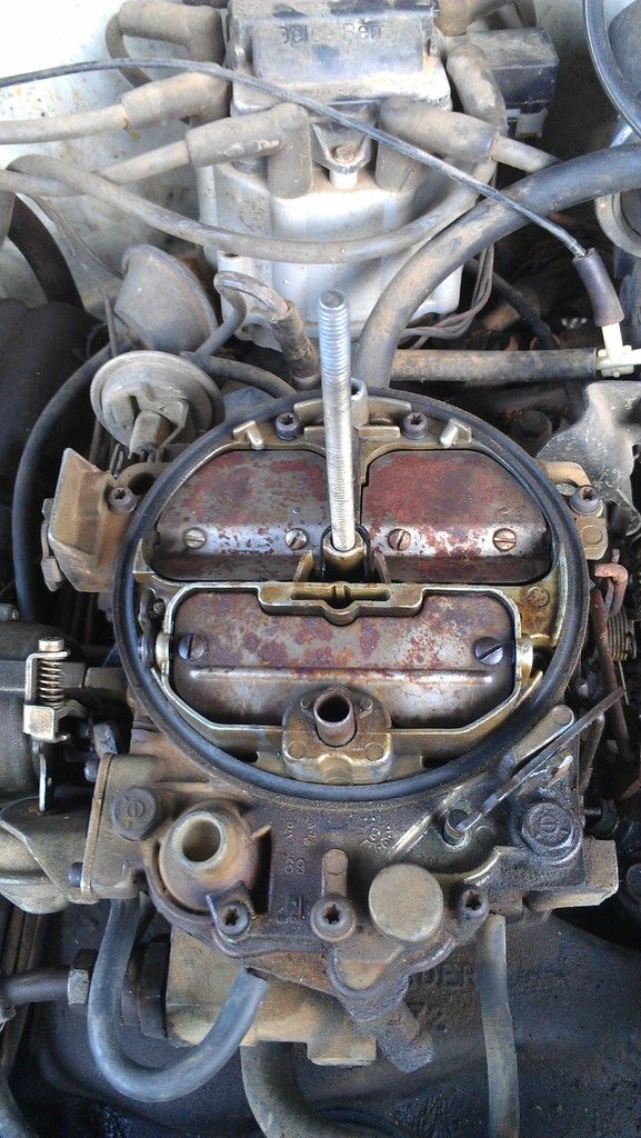

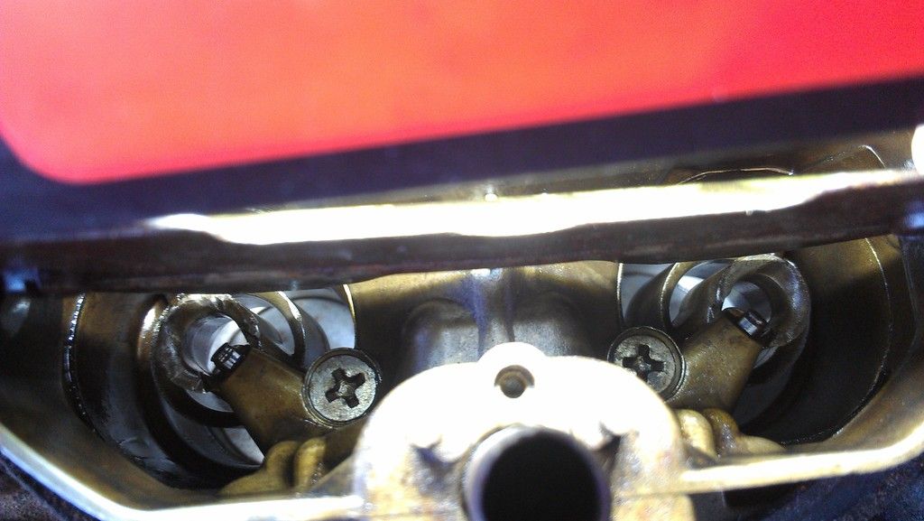

First look in the throttle bore and see if the bore an throttle plates are dirty, black colored. Also, with the truck off, slowly rotate the linkage fully open and back closed with your hand, feeling for any unsmoothness in rotation. This is to check if the throttle parts are dirty and sticking or coked up.
Report back with your findings, also take pics and post them. That helps alot.
LTZ Cheyenne C20

Everything inside looks pretty clean. And linkage feels pretty smooth when I rotate it.
I believe the carbs been rebuilt before because the airhorn gasket dosen't look like its 30 years old and the cover for the electric choke coil is held on with screws instead of the factory rivets.
Let me know if I can take anymore pics that will help.

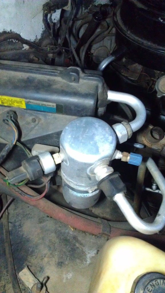

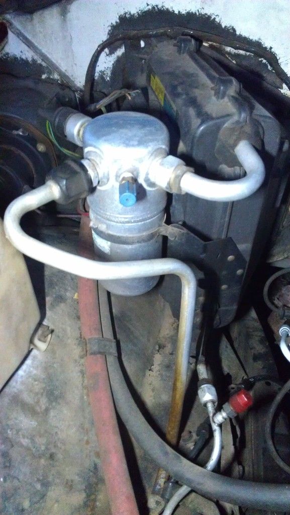

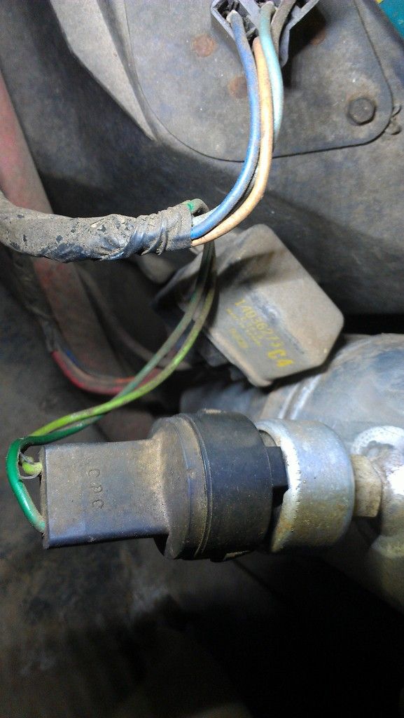

What is the idle RPM in drive with the AC off?  Post a pic of the accumulator and low pressure cycling switch.

Answer BD's questions also. I'm not sure on whether that was California only or not.  The carb looks good so it's safe to say that's not the issue. As BD said, please answer these:
1) idle speed in PARK with a/c OFF.
2) idle speed in PARK with a/c ON.
3) idle speed in DRIVE with a/c OFF.
4) idle speed in DRIVE with a/c ON just before it stalls.
