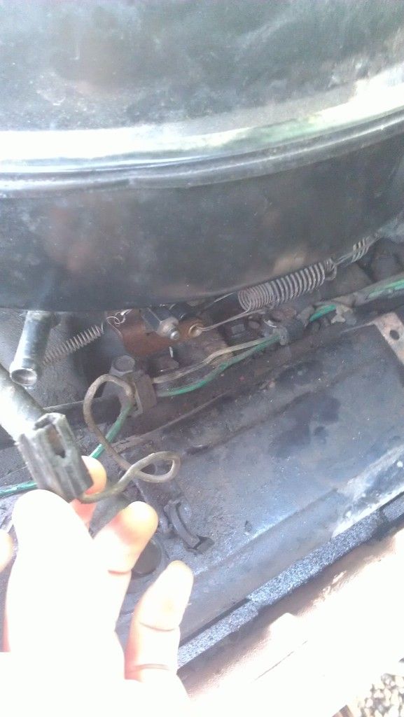

Install an idle stop solenoid and tie it into the light green wire that connects to the AC low pressure cycling switch on the accumulator.  Look around the driver side of the carburetor for a light green wire in a single wire connector that may already exist for that purpose.  The solenoid will energize with the AC and raise the idle speed, so the engine won't stall.  Then when the AC is shut off or the engine is shut down the throttle will close to its base adjustment to prevent dieseling.

Cool I always wondered what that wire and connector were for. So I can just bolt on the Idle stop solenoid and plug in the connector and I should be good to go huh?
Is there an adjustment on the solenoid or do you just put it on?

Clean that wire with some solvent and verify the color.  Idle solenoid circuits were light green.  You can determine whether it is tied into the AC cycling switch using a test light.  Connect your test light to a good clean ground and probe the wire connector to determine if it has power only when the AC and/or Defrost are selected from the dash control.  Typically, idle speed adjustment with the AC on is 50 - 150 RPM higher than idle speed with the AC off.  You can research the idle adjustment specs in the appropriate service manual for an exact RPM setting.

Alright thanks and its the light green one for sure its just dirty and hard to see in the pic.

Well great news guys I took off the Idle stop solenoid off another truck, slapped it on mine, and now it dosen't die in gear with the A/C on.
I drove my old squarebody with Cold A/C blowing in my face for the first time. It was awesome!
I did notice the rpm's are really low though when I made complete stops but it never died. It sounds bada** like it's cammed but I also dont want it to stall out. What would I adjust for that? The Idle speed screw? Or is the Idle stop Solenoid adjustable?

Adjust the solenoid using the hex plunger that pushes against the throttle lever.

Alright I was thinking there was a reason that plunger had a hex on it.
