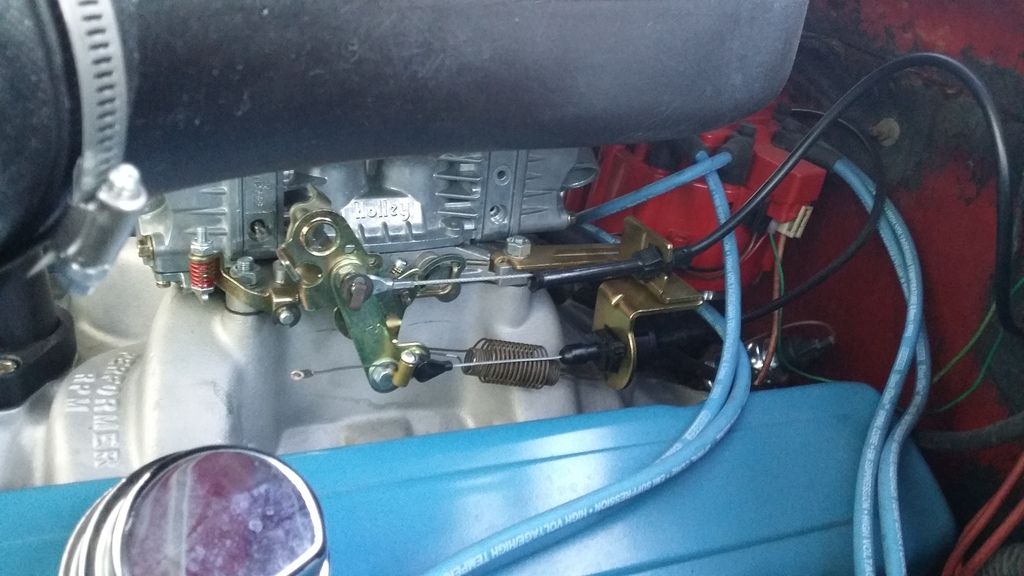

There's an Edelbrock Performer RPM and a Holley 780 on top of my 400.  Behind that is a 200-R4.  I bought all the correct Holley brackets to hook up the TV cable.  The guy that built the transmission says he thinks the geometry isn't quite right.  He ain't the sharpest knife in the drawer.  Anyone ever have an issue with the Holley brackets not being correct?

I have the same throttle/TV cable bracket, I actually cut it in between the 2 cable mounting holes, then I drilled 2 holes in the throttle cable side and cut to slots in TV cable side, so the throttle cable side is the base, bolts to the carb still, the TV cable side is adjustable now, it slides back and forth. I'm gonna find a new bracket for it tho, I think. It works but it could be better. As for the throttle cable, if you mean it's too long and your referring to the loop between the firewall and bracket, that loop is supposed to be there.

« Reply #3 on: October 05, 2016, 06:21:22 am »
Boy, I'd like to see a picture of that.
The only modification I made was to drill a small hole in the cable bracket under the TV cable.  That's where I hook the springs.  The spring tension is a bit too tight but I couldn't come up with a better idea.

« Reply #4 on: October 06, 2016, 01:50:12 am »
If you give me a bit I can take a pick of the bracket and post it. Might be tomorrow morning or tomorrow night but I will do it.

« Reply #5 on: October 06, 2016, 08:49:15 am »
Tah dah.
Again, it's not perfect and could be better but it worked. I would try and find some version of a factory bracket, that's what I was going to do to.

« Reply #6 on: October 07, 2016, 06:43:26 am »
Very interesting.  Thanks.
