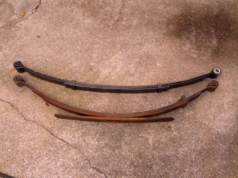

That's because there are no options for lowering leafs, shorter shackle, shackle flip, axle flip(axle over spring) are the three choices for lowering the rear.

Doesn't western chassis make a 3-4" lowering leaf spring?
All that is the company removes a couple leafs and calls it a lowering leaf spring, you can save money and time by going with a flip kit...

Western doesn't remove springs to make it lower.  I have a set on my truck...  I have been very happy with it.
