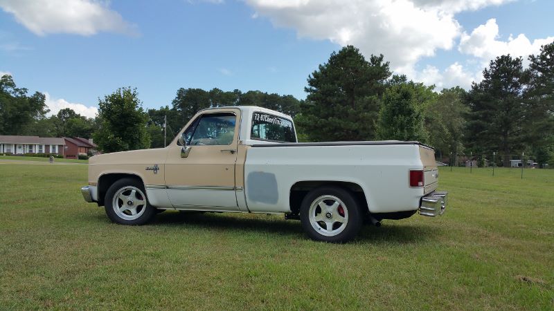

Stock height.  17" wheels with same diameter as factory.
Re: Q&A for those who have dropped their trucks or want to drop their trucks
« Reply #2 on: February 12, 2017, 09:20:12 am »
2.5" Western Chassis spindles front, 4" Western Chassis drop leafs in back (same truck as above and same tires
I know this is an old thread and you might not have the truck anymore but I'm fixing to drop my 86 c10. Curious if you liked the western chassis drop and how it rode? Thanks!
Sent from my SM-A115U using Tapatalk
yes I still have this truck, it is the "73-87chevytrucks.com" truck.  full thread is here: http://forum.73-87chevytrucks.com/smforum/index.php/topic,12120.0.html
Truck rides well, currently about 40K on the suspension, 47K since the LS swap.
I use Western pretty much for all rear drops because they make rear drop springs.  The front is just a spindle, so technically anyones will work, but I just get it all from one place when I can.  Good shocks make a difference too.
Ok great thanks. I looked through your build. Lol way more info than I expected and love the twin turbski setup. I'd like to ls swap mine after this suspension but I'm thinking about just dropping a t56 in with my 400sb for awhile. I need the extra gears that the old  350turbo isn't giving me. Thanks for the reply. This is my 86.
