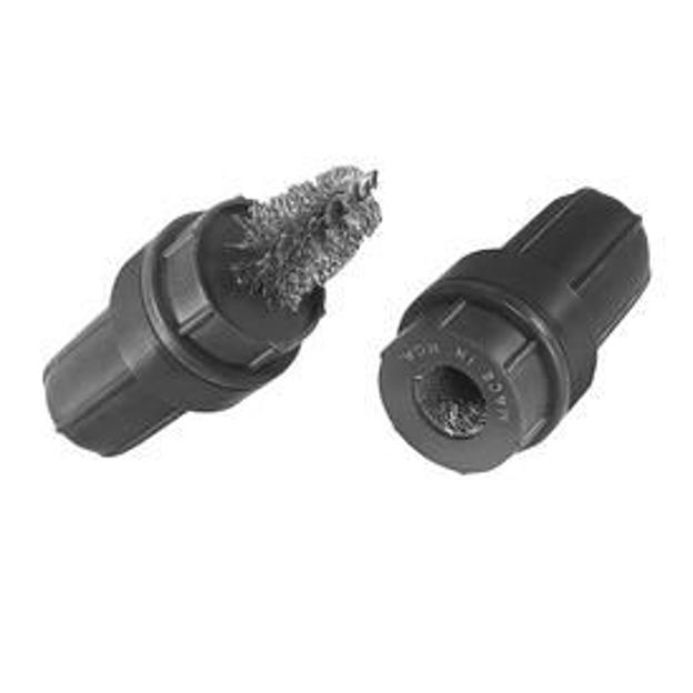

Thoroughly burnish and clean the battery cable connections!
Employ a specially configured battery terminal brush (image) to service conventional battery connections, removing any paint or corrosive salt encrustations. Severe encrustations may need to be chipped or scraped away. Inspect for sloppy workmanship leaving a bulbous (i.e., lumpy) accumulation of solder coating the contact surfaces of battery cable ends. File, scrape, sand, or buff away excess solder to ensure smooth, uniform, and conforming connections. Avoid dispensing acid neutralizers directly to or around the battery. Acid neutralizers consist of highly reactive chemical bases that interact with battery acid to produce salt residues nearly as conductive and damaging as the battery electrolyte. Instead, use clear water and a nylon-bristle brush to rinse away accumulated dirt and conductive corrosive films. Be sure battery caps are fully installed before and throughout the battery cleaning process! Thoroughly rinse all adjacent and surrounding surfaces until completely cleaned of chemical splash. Metallic paints are particularly susceptible to discoloration and etching if acid sits on the painted surfaces for too long. Allow the battery and terminal ends time to dry or, while wearing suitable face and eye protection, carefully blow them dry using low-pressure compressed air. Liberally coat the dry battery posts, pads, and terminal ends with thick lithium grease (arguably the most economical and effective choice), antioxidant compound (pricier but similarly effective), or battery protector aerosol (the most expensive and least effective choice — think of it as liquid money in a spray can — wrapping a battery terminal in a $10 bill won't protect it from corrosion), then reattach the cables to the battery and tighten the terminal bolts to the specified torque, typically 5 – 6 lb-ft (60 – 72 lb-in) for lead posts and pads.
Inspect for star washers, loose connections, and corrosion wherever battery cables are fastened to a battery disconnect switch, relay, junction block, or the starter. Check for large diameter star washers at the engine block ground stud or bolt. Discard any star washer(s) encountered, then thoroughly clean, burnish, assemble, and coat the connections with a good antioxidant paste.
