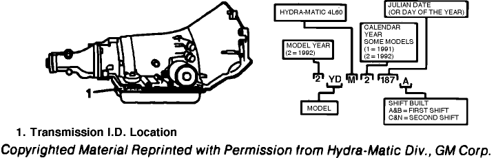

Well there are a few ways to ID the trans you bought. There is a tag on it. There is also a few markings on the case that are unique to certain years. For example the casting line on the pass side that flows upward near the cooler fittings. Let me see if I can find pics....
The transmission identification code is located on the rear righthand side of the transmission above the oil pan, see figure. For code and model interpretation refer to figure. The code numbers that indicate the Julian date, tell what day of the year the transmission was built. It should be noted that the transmission model year starts in mid year. This means that the first transmission built in any model year will start with a higher Julian date.
For example; if the first transmission in 1988 was built on August 5, then the Julian date starts at 218 and goes to 365 (which is December 31). The Julian date will then drop to 001 (which is January 1), and then continue to 217 (which is August 4, 1987).

4YP067B is the marking on my replacement transmission.
So I'm assuming it's a 1984 model. Correct?
