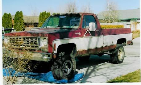

And just for fun here she is:
i6.photobucket.com/albums...3/Heap.jpg
