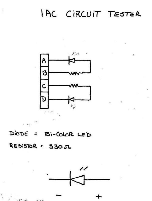

Ahh sorry if you have an old IAC motor you'll need the butt end of it. I'll post the recipe tomorrow I have to scan it.

Did you get the scan Vile?

F!! I totally forgot! Oops I'm sorry I left it in one of my binders at work. I'll email myself a reminder to scan it tomorrow.

Here ya go
