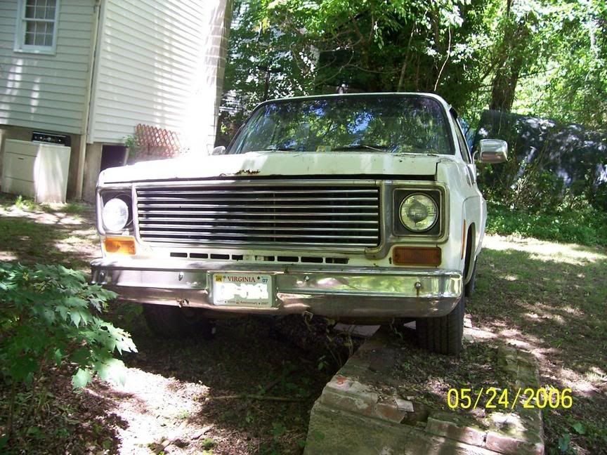

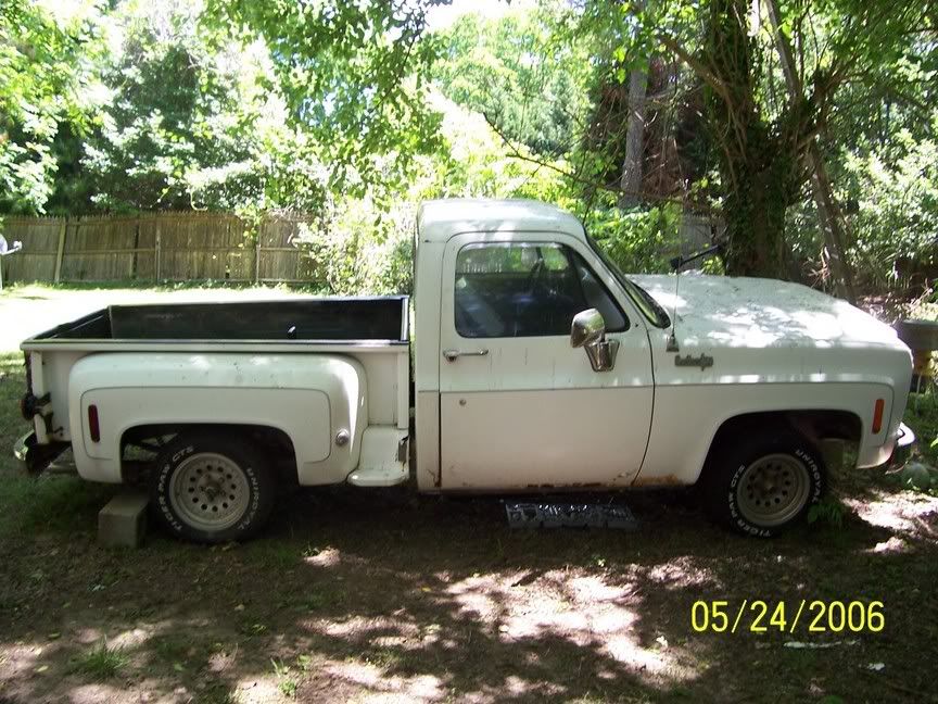

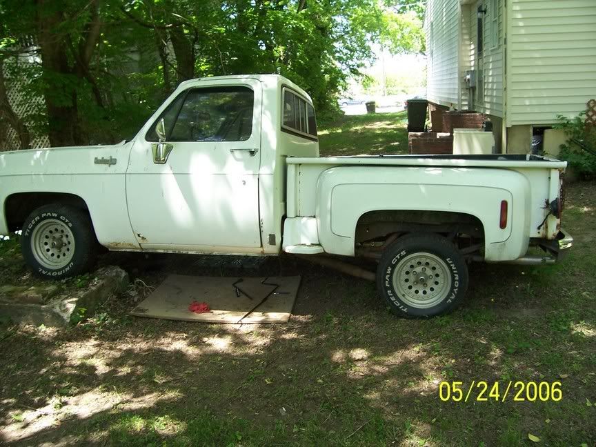

Hello everyone, my name is Andrew I am from Farmville, VA.  I am joining this forum to seek some help along the way of restoring my truck and to hopefully help some others along the way.
Anyways, to the good stuff.  I have a 1973 Chevrolet C-10 with the 350 in it, it is a 3 speed manual.  As far as I can tell so far it is completely stock except for the shifter is in the floor. I am the second owner of this truck, my grandfather owned it before and said he got sick of seeing it sit in his yard so he gave it to me. I dont not know which 3 speed is in it, nor do I know the rear end gearing but I will try to find that stuff out tommorow. It has the rust in the usual places, but other than that its in pretty good shape.
I really love this truck, I got it about 2 weeks ago and have been driving it since the first day.  I finally had to park it because the clutch just had nothing left for me. I am in the process of putting a new one on right now. It works pretty good, it has a few problems which I hope to address with your help.  It will start up great warm and hot, but it just does not idle very well and while driving it will miss.  I am sure it is probably the timing, the stock q-jet carb, and/or the distributor. I do not have a timing light right now so I will have to pick one up to check that.
My plans are do get it running pretty reliably so I can drive it for a year while my garage is being built. Right now I am just laying on the ground to work which is a pain. So what I want to do right now is some motor work to get it running good, and do some body work to keep the rust from spreading. After I get the garage, I would like to do a complete Frame-off restoration but that will have to wait.  Anyways sorry for this being so long, I just hate when ppl just join a forum and start asking questions.  I just want you to know who I am then I will ask questions. :b

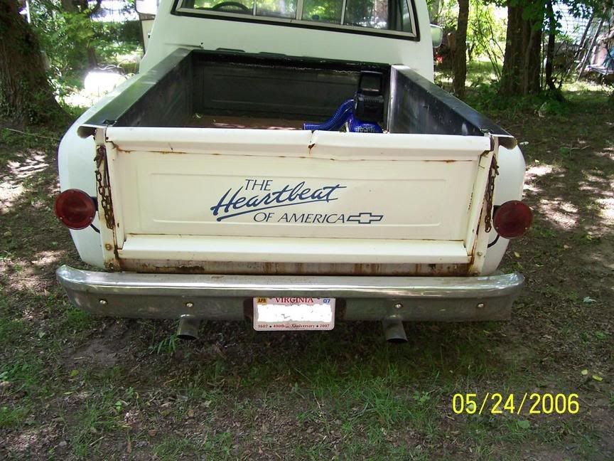

Tail light look like 60s vintage on there.

Yeah hopefully that is the only problem, I was going to replace it anyways with that HEI, I will probably order the HEI and an Edelbrock 600cfm 1406 I beleive it was on monday. Yeah I am not sure about the tail-lights, I guess I was going to order the correct ones from a distributor somewhere. He told me that they just stopped working, so he re-wired the whole lighting system and I guess just put whatever lights he could find on it. Thanks for the help.

If this worked right, you can see how my 76 tail lights used to look. The round lights with the small clear backups were factory for a while. Just dont see many around anymore.
Nice to see another Stepsider.

Both my 64 & 66 step sides had those lights, but never seen them on a newer truck. I was going to say leave them on anyway they look cool. I
