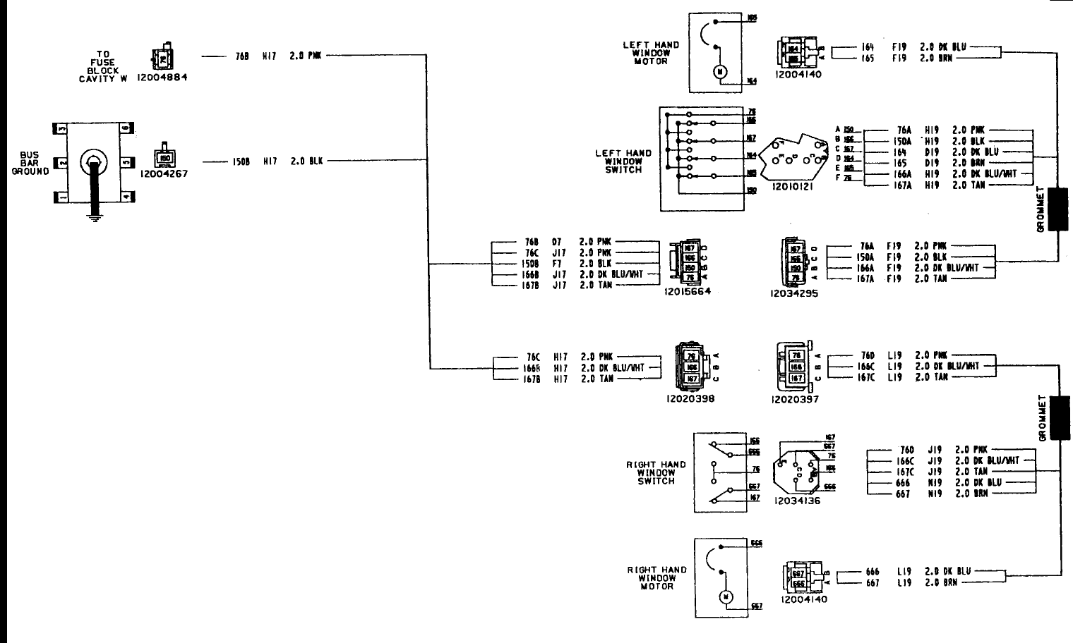

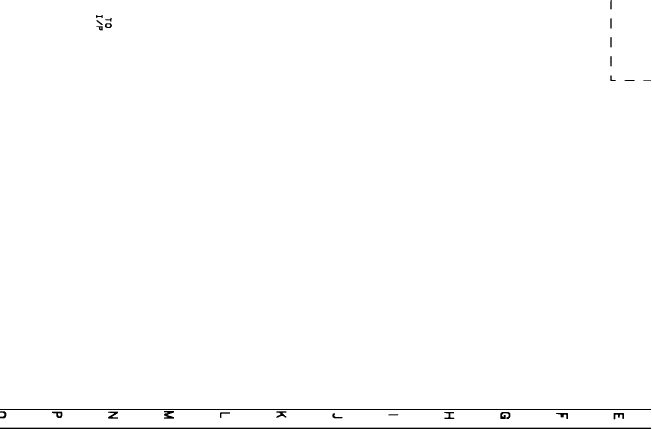

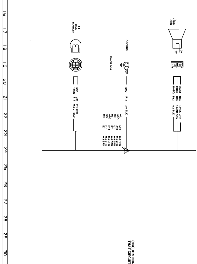

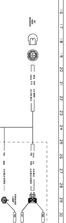

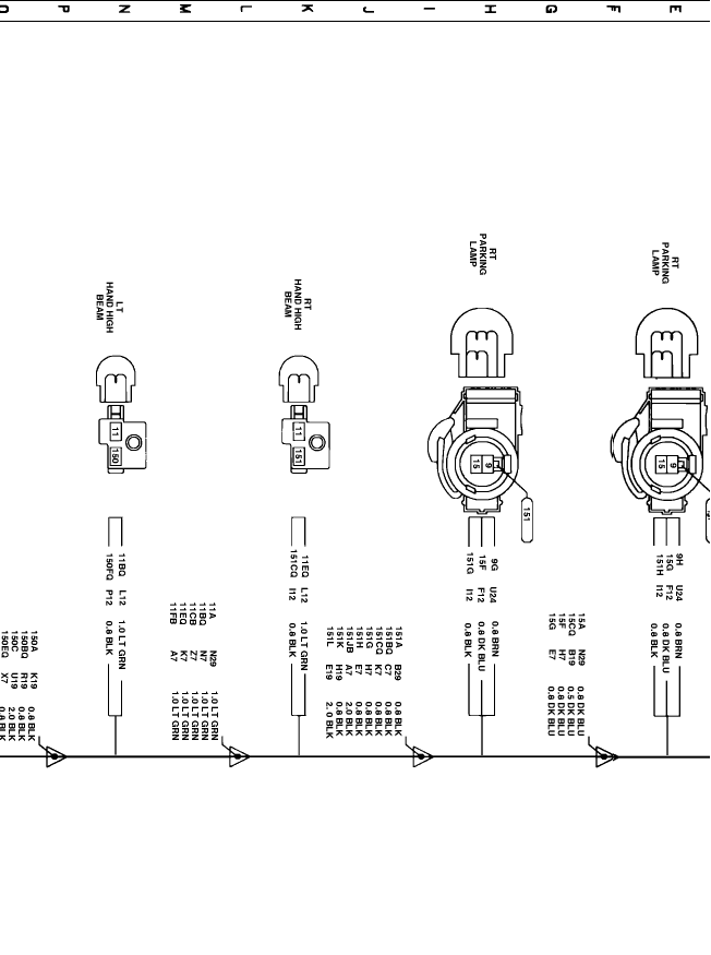

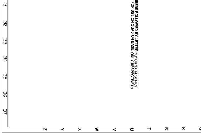

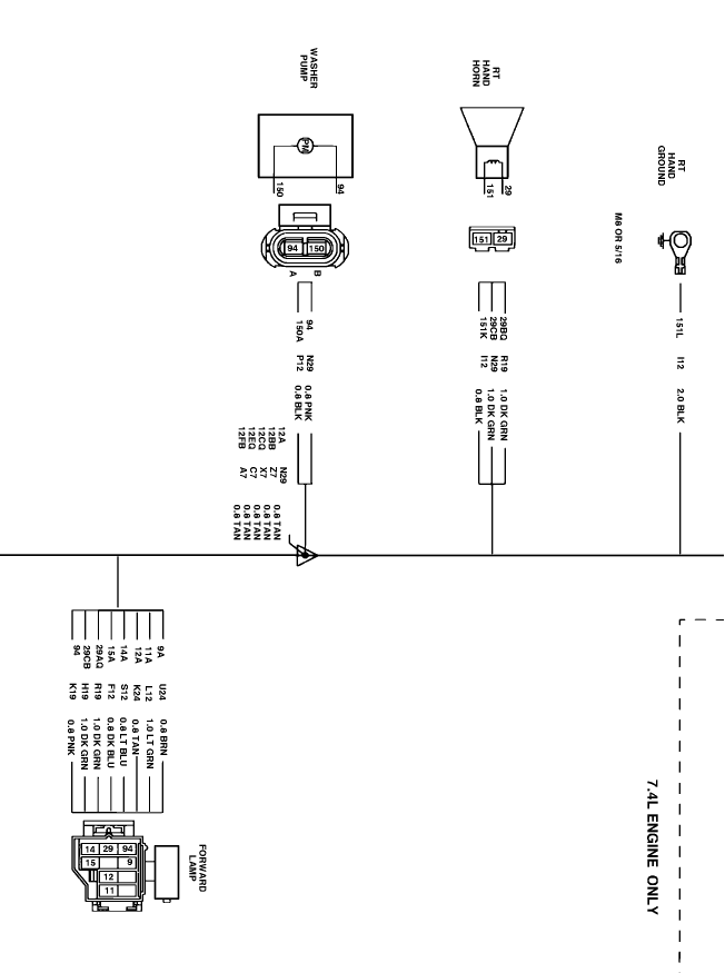

I AM THINKING ABOUT PUTTING A 4 HEAD LIGHT FRONT END ON MY 79 OFF OF A 87.I HAD SEEN A WIRING DIAGRAM ON HERE BEFORE BUT CAN NOT FIND IT NOW. HELP!
Re: WIRING DIAGRAM FOR 2 HEAD LIGHT TO FOUR
« Reply #1 on: August 15, 2006, 05:52:00 pm »
You better print these after all that ! :rollin
