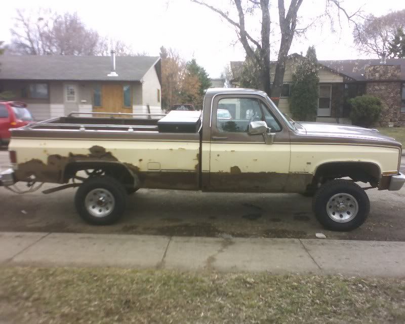

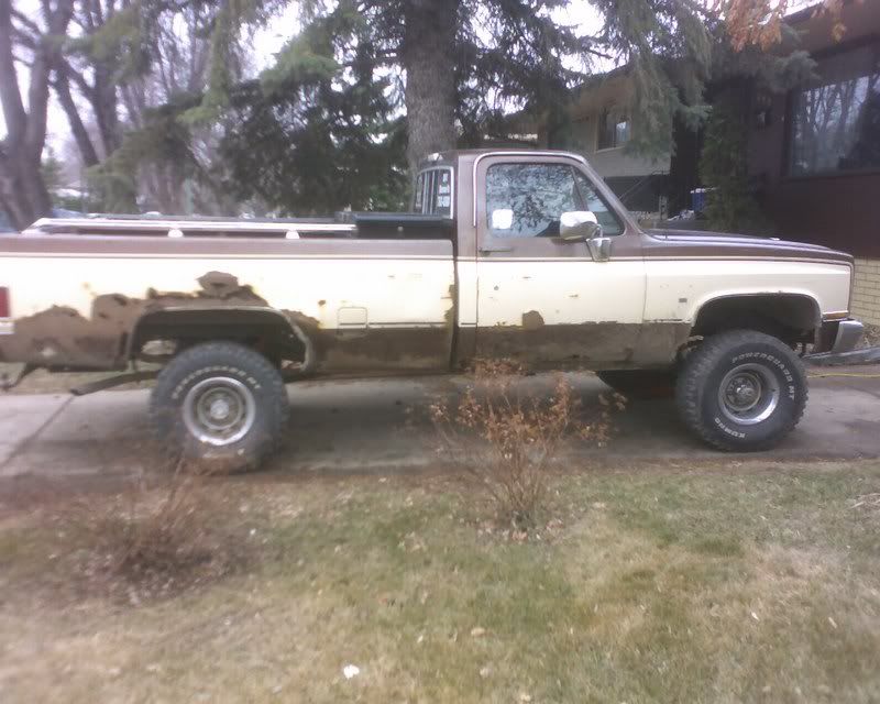

Hey there, first off I have a 1981 Chevy 4X4 1/2 ton.  It has a 350 with edelbrock intake, mild cam, and runs strong to a th350 tranny, with a np208 transfer case.  I use to run 33 inch mudders but I have just started a business and need my truck to haul a 18 foot car hauler with a 3500 pound compact excavator plus attachements so I switched to some aluminum rims with 235\75\15  8 ply tires.  The truck has 2.73 gears in it and is just a dog down low.  Putting the smaller tires on helped some but I recently found out both the front and rear diffs need to be rebuilt so I am considering a gear change.  The truck is going to be getting a complete body work job soon as well so don't mind the rust in the pics.
What would be the best gears for me to use?  And would I just need to swap the crown and pinion?  It has a 12 bolt rear and a 10 bolt front.
Whats size of ring/pinion gears would i need, i see listings for 7.5 inch or 8.5 inch, I am new to regearing so any help or advice is appreciated.
Here is a pic with the 33s
And here with the new little tires.
