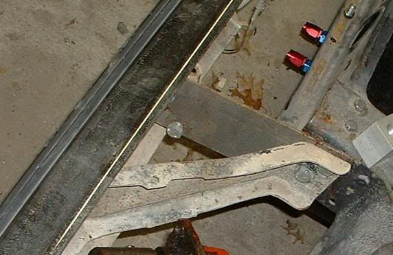

« Reply #7 on: May 25, 2007, 06:36:24 pm »
Do these look right???
Re: HELP ME!!! BUMPERS ????
« Reply #8 on: May 25, 2007, 09:42:31 pm »
yeah those are them! Send me an email at Sabaka454@gmail.com

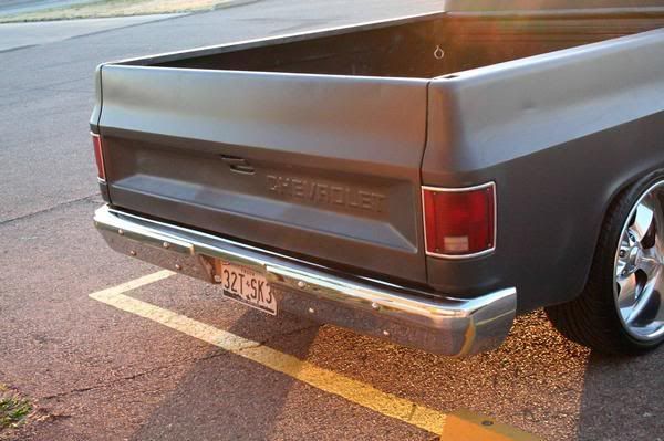

« Reply #9 on: May 26, 2007, 08:16:23 am »
i got this one from   and shortened my stock bumper mount
« Reply #10 on: May 26, 2007, 08:51:30 am »
that looks cool, I thought about doing something lilke that too because I hate the gap between the body and the bumper on some of them I've seen. The blazers look ok with the Filler panel in there -

The brackets blofish posted are not going to work on a 73-80 GM truck.  I have my bumper and brackets off and none of them look like that.  Unfortunately, I can't get a pic because they are at my painters.
As far as sliding the bumper in, all one needs to do is elongate the holes on the brackets where they bolt to the chassis...thus allowing the bumper to slide in closer.  However, if you have 56" springs, this will not work as the bracket sits tight against the rear spring hamger..so you will also need to shorten the brackets as well as elongating the holes.
The filler panel (or gravel shields as they are called) are basically flat pieces of steel (with added ribs for strength) about 8-12 long that bolt between the top sides of the bumper brackets.  There are two total, one for each side of the truck.  You could easily make one nice long one, paint to match the truck, and would look 1000 times better.

The pieces blowfish showed on the pics. are the center brakets for a suburban and/or blazer. This center set of brakets will not fit the trucks, since burbans and blazer frames are longer.  you can use the outside brakets from a burban on a truck only!
Offline Leadfoot
  • Posts: 81
« Reply #14 on: September 24, 2007, 08:02:34 am »
CORRECT..went thru this a few months ago on mine..you can use the burb outter brackets,but not the inner..I fabbed some from flat 3/16" steel,cut to shape and drill holes..easy project..
