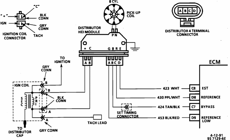

Next question: I have an old pigtail I want to use but the colors are wrong.Does any one know where the pink wire from the coil  should go? To the yellow on the right or to the black on the left???
Thanks

Re: TPI onto 86 Block
« Reply #22 on: July 11, 2007, 02:42:59 pm »
what year is your harness?
              ⌠ŻŻŻŻŻ'   [☼===☼]
Offline 123 pugsy
  • Posts: 925
« Reply #23 on: July 11, 2007, 08:00:23 pm »
1992. I've got the wiring diagram but I'm not sure about how to figure out which should be pink and which should be white.
« Last Edit: July 11, 2007, 08:06:00 pm by 123 pugsy »
Pugsy
76 C10 LWB
TPI 350
« Reply #24 on: July 11, 2007, 08:27:28 pm »
You've got two connectors . One has 2 pins and the other has four pins correct?
Small connector Cavity A is white Tach Signal
Cavity B is pink. B goes to the ignition switch B+
The 4 pin connector goes to the ECM and is
A BLACK/RED                     D9 @ECM
B TAN OR TAN/BLACK          C7 @ECM
C PURPLE/WHITE                D8 @ECM
D WHITE                           C8 @ECM
              ⌠ŻŻŻŻŻ'   [☼===☼]

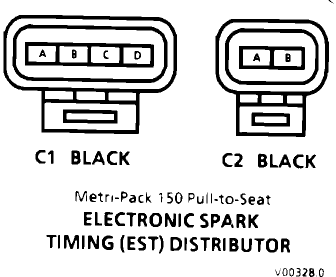

Thanks Vile. Yes I have a 2 and 4 pin connector. The 4 pin connector I have no issues with. I was missing the complete 2 pin harness. I could only find the coil end to buy as replacement and I found an end to fit the module in my parts stock.Only still one problem. If you look at the photo above where the pigtail goes into the module, I checked and there are no letters on the module. Should I assume "A" would be on the left and hookup the white to the black and "B" would be on the right and hookup the pink to the yellow?
EDIT: I found this drwg. It appears that the pink would go on the left and white would go on the right.
« Last Edit: July 11, 2007, 09:16:07 pm by 123 pugsy »
« Reply #26 on: July 12, 2007, 08:08:27 am »
Here's a connector view for you:
              ⌠ŻŻŻŻŻ'   [☼===☼]
Offline 123 pugsy
  • Posts: 925
« Reply #27 on: July 12, 2007, 09:04:59 am »
Excellent drawing. Thankyou.
