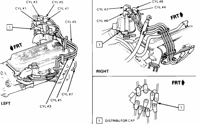

The EGR solenoid has nothing to do with it. Keep the timing around 36° total. Make sure the egr valve isn't sticking open at all. Vacuum is still at 14inHg after you advanced the timing? What's your map voltage with the engine idling? If you didn't hook up the A.I.R. don't worry about it. I know this may sound stupid but double check your firing order carefully and that you installed the distributor correctly. Finally unplug the knock sensor and take it for a rip to see what it does.

Firing order is good.

You are absolutely 100 % positive your firing order is good no #5 and #7 crisscrossed?

Firing order is correct.
