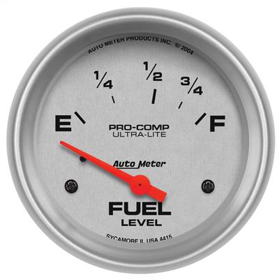

My question is Im going to be replacing my fuel guage with a tach, so Ill be installing a smaller fuel guage like
  So trying to find out what Ohms I will be needing.

0-90 ohms is stock
