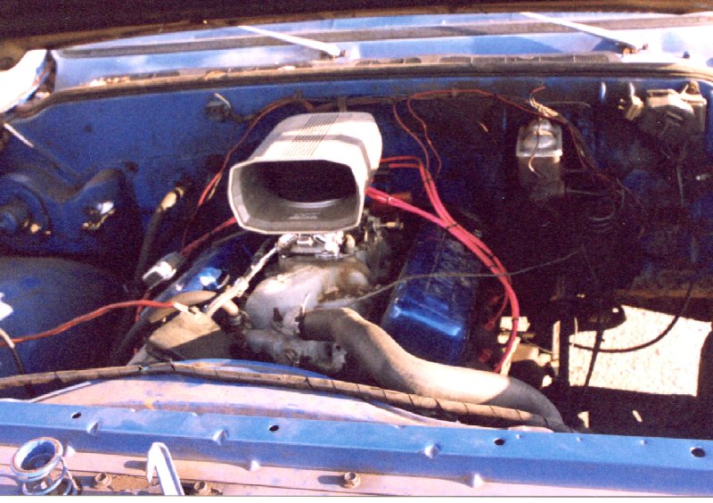

I have this 454 that that I built back in 1992, it is going to be converted to EFI (Hilborn style)
This is when I first got it running:
This is what it looks like today:
When it was running with, well, a HUGE cam, closed chambers and a 800 Holley with a stick shift and 3.42 gears and 28" tall tires it would get 12mpg when my foot wasn't in it.
