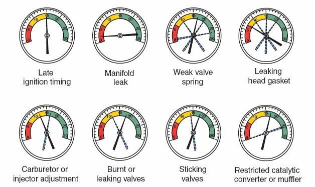

Re: Finding Vacuum Leaks
« Reply #14 on: October 07, 2007, 03:20:11 pm »
Figured this pic might help some of you
              ⌠ŻŻŻŻŻ'   [☼===☼]
