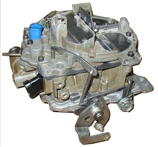

The choke for a Q-jet is mounted on the primary side.  Yours if it is Computer controlled should look like this:
Non computer controls look like this:

And by the way, thanks a heap for your pics CaptKaos, I can now see what my carb is missing...

Dave, looks like someone has replaced your Carb with a Non-Computer/Electric Older one that doesn't have a Choke.
Your '86 should have one that looks like the one I have on my '82 Olds Cutlass Wagon(If not a Manual Carb mounted Automatic Choke, which still looks like the pic, but minus the electrical connector to the side of the choke).
Not My Carb Pic, but looks like it.
The Round Object on the Left with the Connector going to it, is the Electric Choke, and the Vacuum Canister infront of it, is the Choke Pull-Off Valve.
1980's Electric Carb, with Automatic Manual Choke:
Your Current Carb, is the exact one I have on my '77 GMC, it is refered to as a '74-77 Quadra Jet Model 4MV with an Automatic "Divorced"(Means has a small choke mounted on the Intake Manifold and connected to the Carb via a rod).
Personally I prefer the Non-Electric Quadra Jets, for their ease of rebuild, but it looks like I have to add an Automatic Manual/Electric Choke, like you may want to.  :-\

Thanks for the pics Mr. Dragon, the carb has been out of my hands since Thursday when I took it to the rebuilder but I believe it looks more like the second pic posted by Captkaos (the '80's non computer controlled) with mine missing the vacuum pull-off(s) along with the linkage for the butterfly... the jury is still out on this because I haven't heard back yet from my guy doing the rebuild... talked to him Sat and he's aware of the problem.
