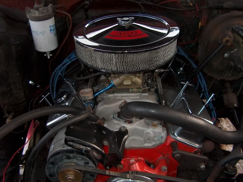

Here's some recent pics of engine re-done.

Your Project is coming along nicely, especially like the bumpers 8) My Grandfather was a DieHard Dodge Fan for the longest time, till he helped my father rebuild a few Chevy's, then he became a Buick Fan(Originally had a new Apollo when I was little) cause of the Comfy Cruiser Factor ;D
Questions for you, what electric fan set up are those(Look like Flex-a-lites to me, so got a part number by chance??),how much did they set you back, and where did you get them from??

Ofcourse if you are lazy or senial like me, you could always replace that plug in your intake(can be seen in lower right in pic, below upper hose), and replace it with an (Neihoff or other brand similar switch that can be cross referenced to correct number)DR134AK Coolant Thermal Temperature Switch(Actually what goes in place of that plug on later model ECM/PCM Controled Vehicles) or similar found at Advanced Auto.  What you do, is wire in the relay(As per Vile), wire in the thermal switch next, and have your dash mounted switch wired in as a secondary...
Thanks Again for the Fan info, I thought they looked familiar!  I used to dust the boxes of the ones in my Old Store every week, ofcourse it figures that I would finally have a use for them(Could have gotten them for $20 a piece since they were clearing out alot of stuff that had been left by the Previous Company)Doh!

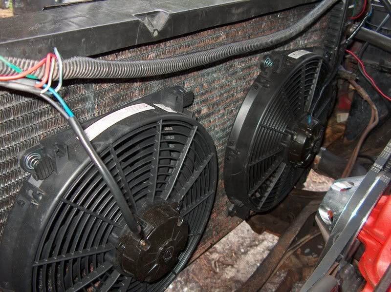

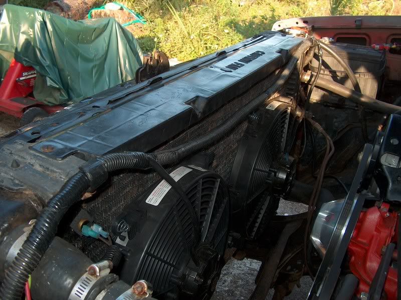

Alrighty, here's some pics of the new founded wiring job on the fans. Alot of the mess has been cleaned up so it looks way better and not like a hack job.
Notice how the wires are nice and tucked away.  ;D

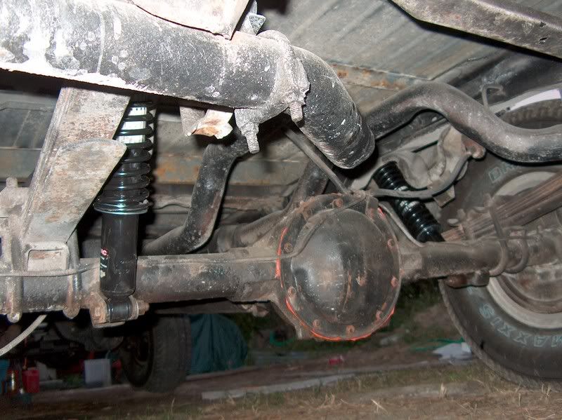

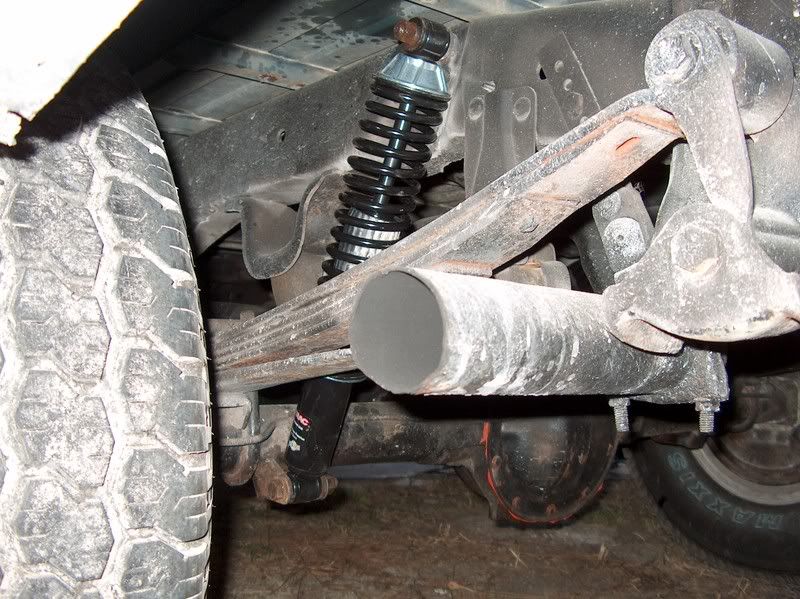

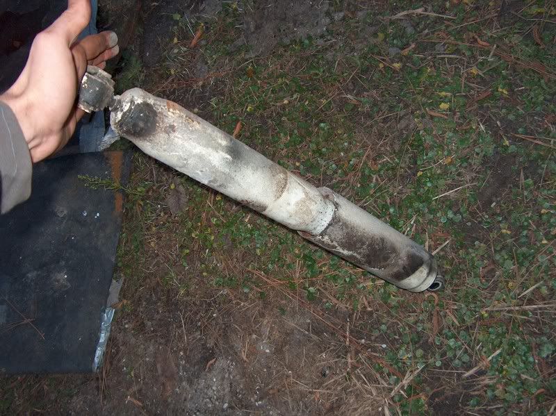

Oh and also, I got a new pair of shocks and put them on today. They are WAY better than what I thought they where going to. Cost $116.00 for all 4 and they are SWEET! I recommend them to everyone who want new shocks for they're LWB 4X4 Truck. You can pick them up at advance auto.

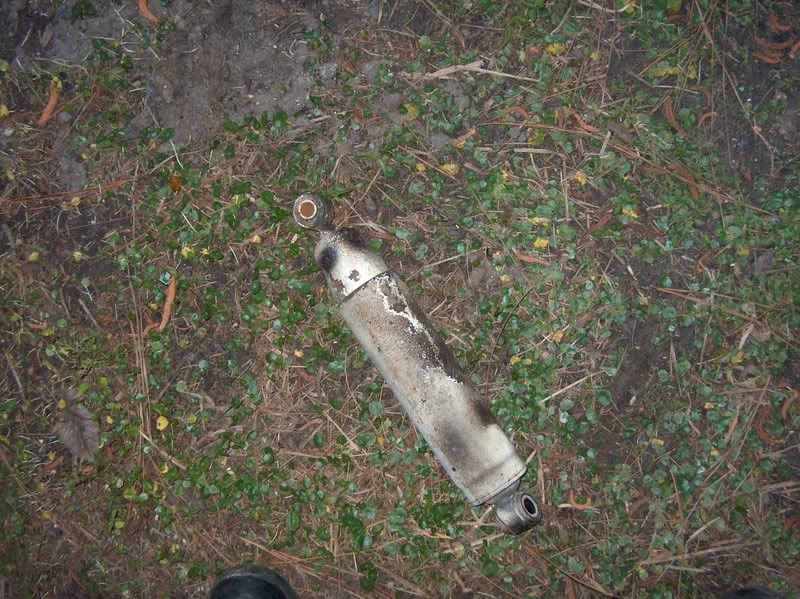

And the old shocks where HORRIBLE! No wonder the whole truck would bang and shake on a bump. They wouldn't even extend after I compressed them. A two year old could compress them.
It also turns out they have a life time warrenty and they've been on this truck since 1985 so my dad plans to take them back and get a new pair for him self. =P

Hey Bomber!   Great project!  I am enjoying looking along through your progress on this project.   Be sure to keep us posted of how it comes along.
Very curious as to what your fans are mounted to  ???  I did a dual electric fan project in my truck too, but my mounts are clearly different.  I am running a dual relay setup in mine, with a toggle lighted switch in the cab.  It is currently not hooked up for a thermostatic switch but the wiring and sensor are in place...
Check out this thread if interested.  I'd like a bit more detail on your mounts just out of curiosity...
