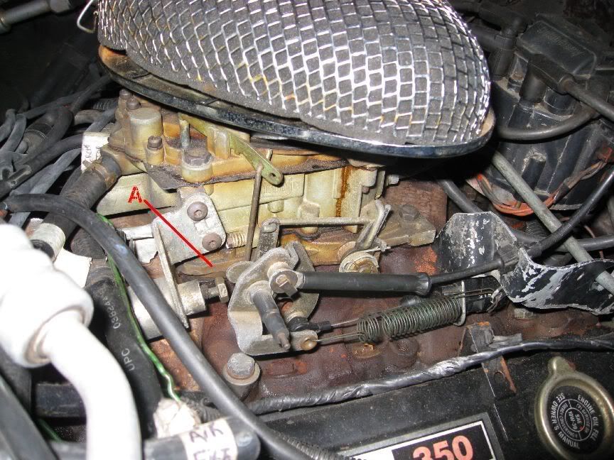

Two issues i'm having are:
1) The throttle gets "sticky" alot;  i can put my foot under the gas pedal and lift up and that brings the rpm's back down, so it's not too serious.  But it shouldn't be like that.
2) It "diesels on' sometimes after i shut it off, which probably has something to do with the idle-stop solenoid thing (fig.A) which i'm not sure how to adjust.

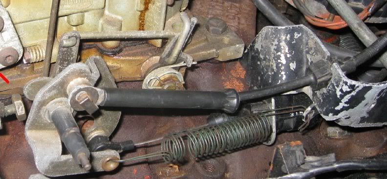

i've made a close-up, so as to better asertain if i've hooked up something improperly:
Lastly, i wonder if the routing of the throttle cable is ok?  i've traced it's route in yellow.
NOTE(S):
i'm using the edelbrock "pro-flo" air cleaner only because i feel that it is easier to tune (and see) everything right now.  After everything is in order, i will probably revert to the stock air cleaner housing.  i got the proflow off of another car that i bought and have since sold.

You could spray your carb down with WD-40 to free up the stickyness. Your cable looks fine. Now after lubing up your carb doesn't work than your cable is sticking and need to chage it out.

The pedal feels ok, i suppose---not too hard or soft i guess.  But do throttle springs weaken over time?  i'm thinking it might be the springs because while moving the throttle by hand, i noticed that it returns back to idle slowly---it doesn't snap back like it probably should.  Also, if you look at my pictures, there is a gap in the springs near where they connect to the throttle arm.  Is this normal?

No, that is not normal. The springs have been stretched too far sometime during thier life. Try replacing them, while they're off check throttle plate action, if stiff rebuild the carb. The dieseling is most likely your timing too far advanced.

1) OK, i've pretty much solved the dieseling problem;  It turns out that the idle speed was too high.
2)And, i actually touched the throttle return springs--- and they have no tension!  So, i've  ordered the stock springs from a chevy dealer.  i was going to get the return springs thru jeg's or summit, but the problems is that jeg's and summit now charge a $10 or $11 handling fee with each order (when did this happen?)  And so, the handling fee would have been higher than the springs themselves----i was going to get the  Gardner-wescott springs from summit for $7.95, but then the total would have been $18.90.
Someone suggested that i try a chevy dealer and they were $2.95.
