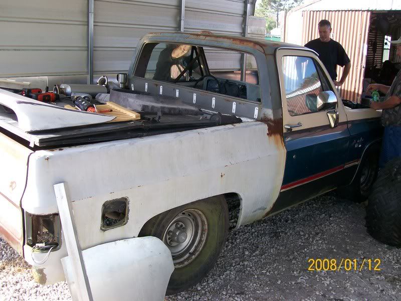

I found this on a nova site. A guy was looking to buy the 454 out of it and he ended up buying the whole truck for a good deal. Would it be hard to do something like this. It looks like a shortened c10. Or is it just a blazer? Would this make a good drag truck?

it kinda looks like a Blazer to me...then kinda not...

Looks like a Blazer frame, pickup cab, with Blazer quarters welded on. There is a guy that owns a shop about a half hour from my house. He had a mud truck years back that he had done this too. I tried to buy it off him as it was just sitting behind his grandmothers house for several years, he wouldn't sell it. That was about 12 years ago, it disappeared but I don't know what he ended up doing with it.

My best guess from one photo is it started out as a Blazer,(gas filler,no stake pockets,ect.) with the front of the body cut off (in the right place to get the front mounts,engine to firewall,fenders, ect.) & a truck cab put on. Truck bulkhead & tailgate put on. I've not seen or done one, but does not seem it would be too hard (I do own a bodyshop though). You would have the complete frame from the Blazer & enough metal on the quarter panels to go up to the doors (some would need cut off). If you set the cab/front clip on & trim the Blazer floor & quarters until things line up, cap the front of the quarters , I would use the front of truck bedsides & bulkhead to make it look stock. Every thing else would stay as normal, Driveshafts,brake lines & cables,wiring & in the front, from the front of the seat forward would all be the same. Do one! Lorne

I just got a reply from the guy and he said yep it's just a truck cab on a blazer frame. He said he's trading it back to the previous owner for an intake manifold.
