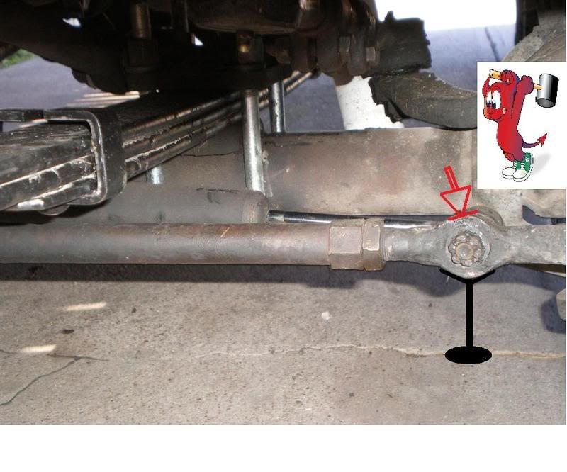

I'm trying to replace my old steering stabilizer with a new one from Tuff Country and I'm having difficulty getting the old one off. Yes, I know theres only a few bolts holding this thing on but one of them is confusing..I can get the bolt holding it on to the axle off easily, along with the one on the front of the steering linkage that has a cotter pin going through it, but the one thats directly in between the linkage and the stabilizer is the problem. Which way do I need to turn it? It wont budge..I've soaked it down with Pb blaster too, but its not moving..Sorry for the dumb question..Heres some pics

/you don't need to turn it, it's a tapered interfernce fit into the center link. Just support the link with a jack directly underneath it and strike the center link above the stud with a hammer. It will pop out. If you still can't get it use a pickle fork.

Ok, what do you mean by link? the steering linkage or something else? Are you saying that I should just support the long rod with a jack and hit the threaded part that the nut with the cotter pin is on until it just pops out? Thanks.

No! Don't ever strike the threads all that will do is ruin the threads and mushroom it! It's shock therapy, support the center link and shock it with a hammer.

Alright thanks man, that illustration helped alot lol, I'll go give it a try
