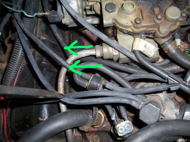

1) i am also thinking/wanting to  put a fuel pressure gauge on my stock Q-jet with stock fuel line.  But of course it is very tight.  i suppose i could get a tube bender and bend the line slighly to the left (if viewing from the front of the truck)?  i don't really want to cut into the stock line.

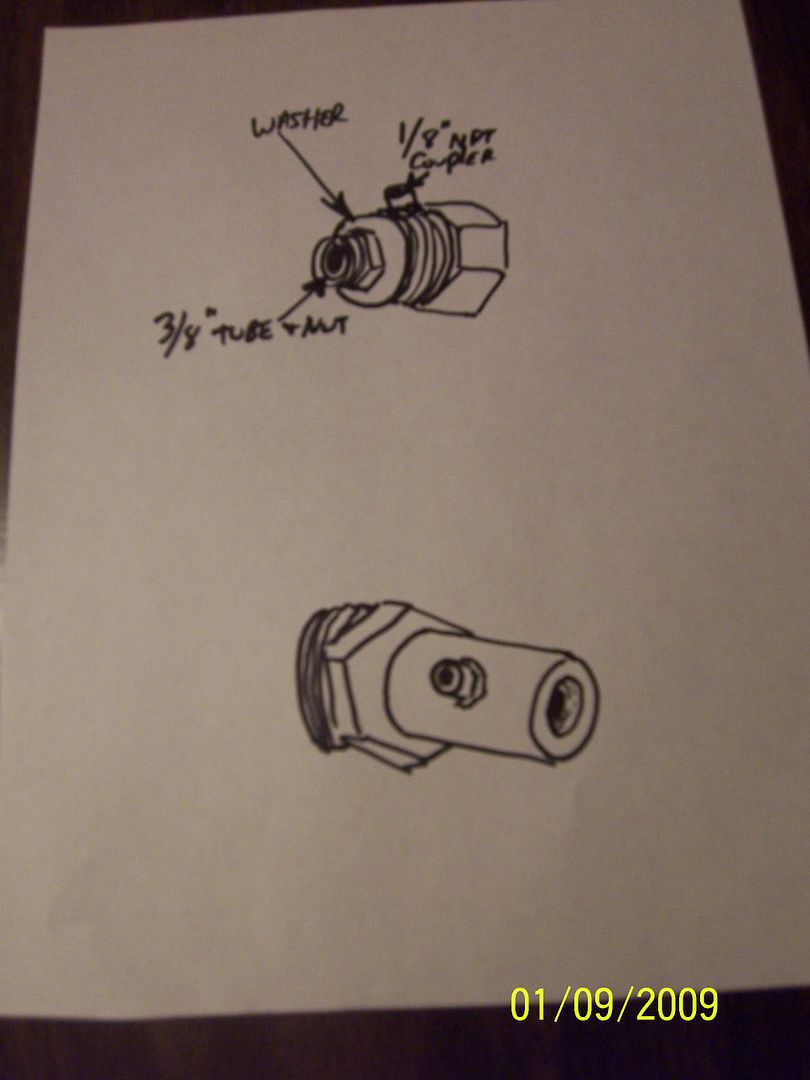

Stewart, Yes It's 3/8" tubing. Here's a quick scribble of them...It was easier than putting my coat & shoes back on to go to the garage, besides it's cold out there!
 The top one is the "test" version. Basically I took a 3/8" tube cut off 1/2" from the nut & sat it on a plate of steel, then slid a 3/8" fender washer over the tube & brazed the tube to the washer. Then laid the "big nut" on the plate (open end up) & brazed the washer on. with the 1/8" coupler mounted in the side, all you need to do is unthread the vehicle's fuel line & thread the new one in the carb & then the fuel line into the new "big nut".
 The lower one is self explanatory, I think. Lorne

Is that drilling & tapping the carb body just behind the "big nut"? I've seen that done & I agree it seems a little risky, the casting is not very thick there. For a perminate set-up I like the bottom one in my drawing. Lorne

Yes, it's drilling+tapping and i don't like it.  i think the best way is to bend the fuel line so that the inverted flare of the line ends up an inch or two to the left of the fuel inlet nut.
Example:
Then get an inline adapter for the gauge and the appropriate AN or NPT fittings.  Then, you have a leak free worry free and more or less permanent solution.  Or use your BOP nut idea.

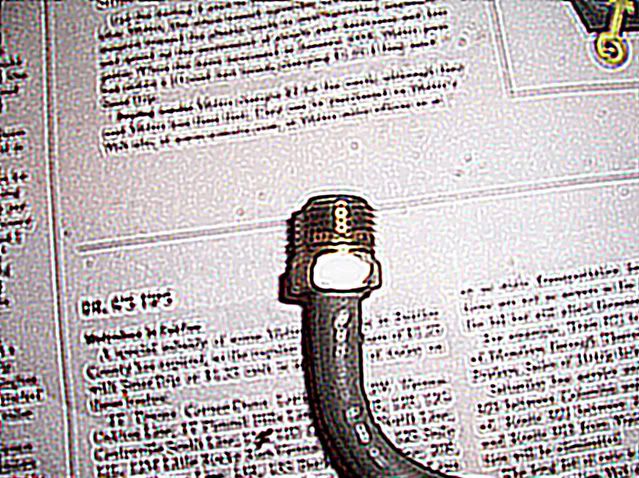

While we're on the Q-jet nut discussion....Ponder this one a bit. I don't think you'll find it in the Summit catalog. ;) Lorne

Is that a y-fitting commonly used for multiple air hoses on one line.  Kinda like THIS but remove the quick connects?

Smitty, No...It's just a homemade piece. A regular Q-jet "big nut" with the inverted flare seat bored out. I buy steel 37* hose ends at a local hydraulic supply store & brazed it up. Lorne
