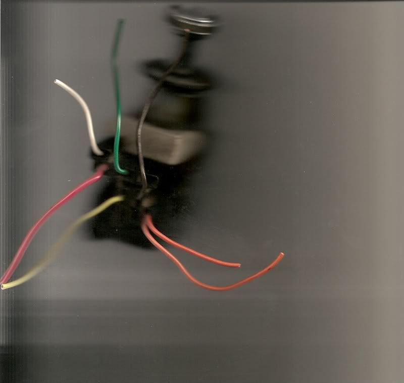

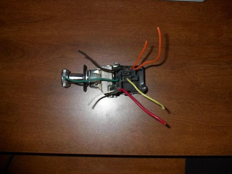

Ok according to my old stock switch that I cut the wires from it is:
White to 961 BLK
Red to 928 RED/BLK
Yellow to 907 BLU/YLW
green to 930 BRN
both orange to 959 ORN
brown to 929 BRN
That I know is correct.
This is better:
« Last Edit: February 21, 2008, 09:08:08 pm by JJSZABO »

Offline soiset
  • Posts: 5
Re: Need Wiring Order for 1984 Headlight Switch
« Reply #5 on: February 21, 2008, 09:14:42 pm »
Now THAT I can follow.  I've traced it out on my old switch, and it seems to make sense.  Thanks for your help.  I'll try to get a picture of truck-truck on here to show my appreciation.
