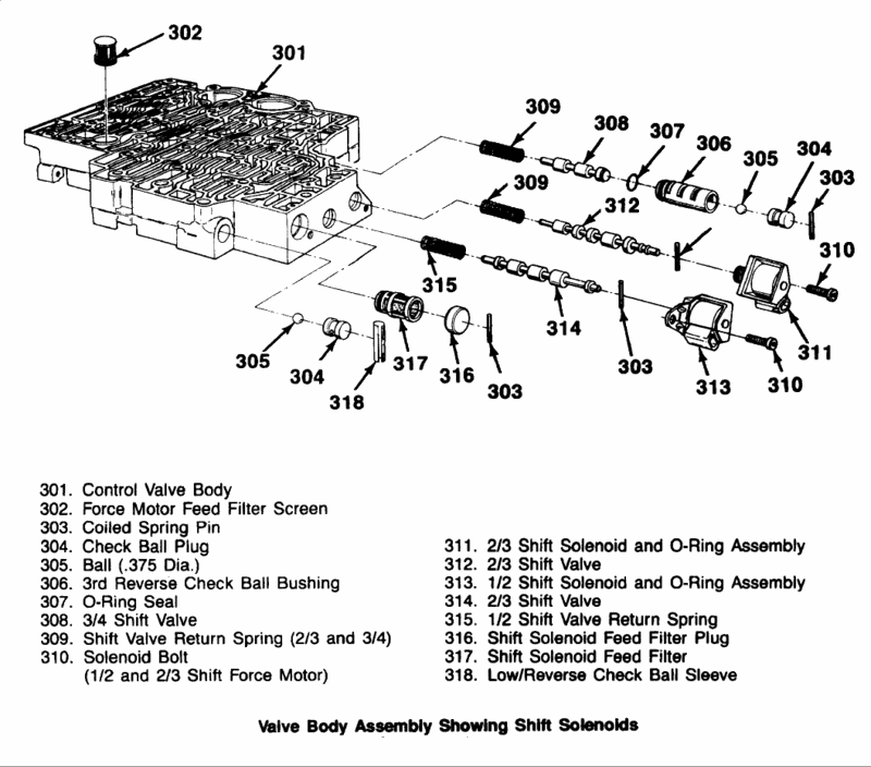

Can anyone provide a picture showing the 4th gear valve in the vavle body so I know which one to un-stick when I pull the pan?

Re: Overdrive
« Reply #22 on: April 09, 2008, 10:34:59 am »
no, you will not have the shift solenoids like pictured above. You'll need to drop the valve body. Take a pair of dykes or needle nose pliers and slide the roll pin up and you can remove the valve. Are you capable of taking apart the valve body and will this void your warranty?

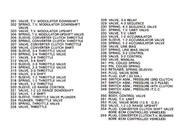

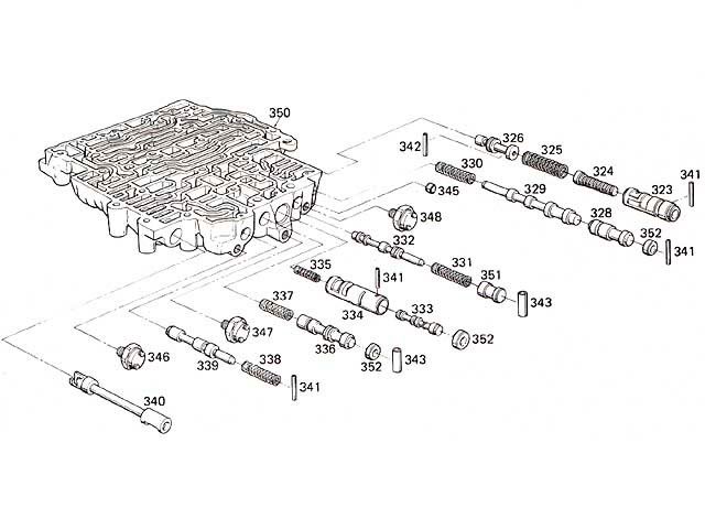

« Reply #28 on: April 09, 2008, 09:34:18 pm »
Let me log into ATRA and see if I can find you a diagram
Here ya go
